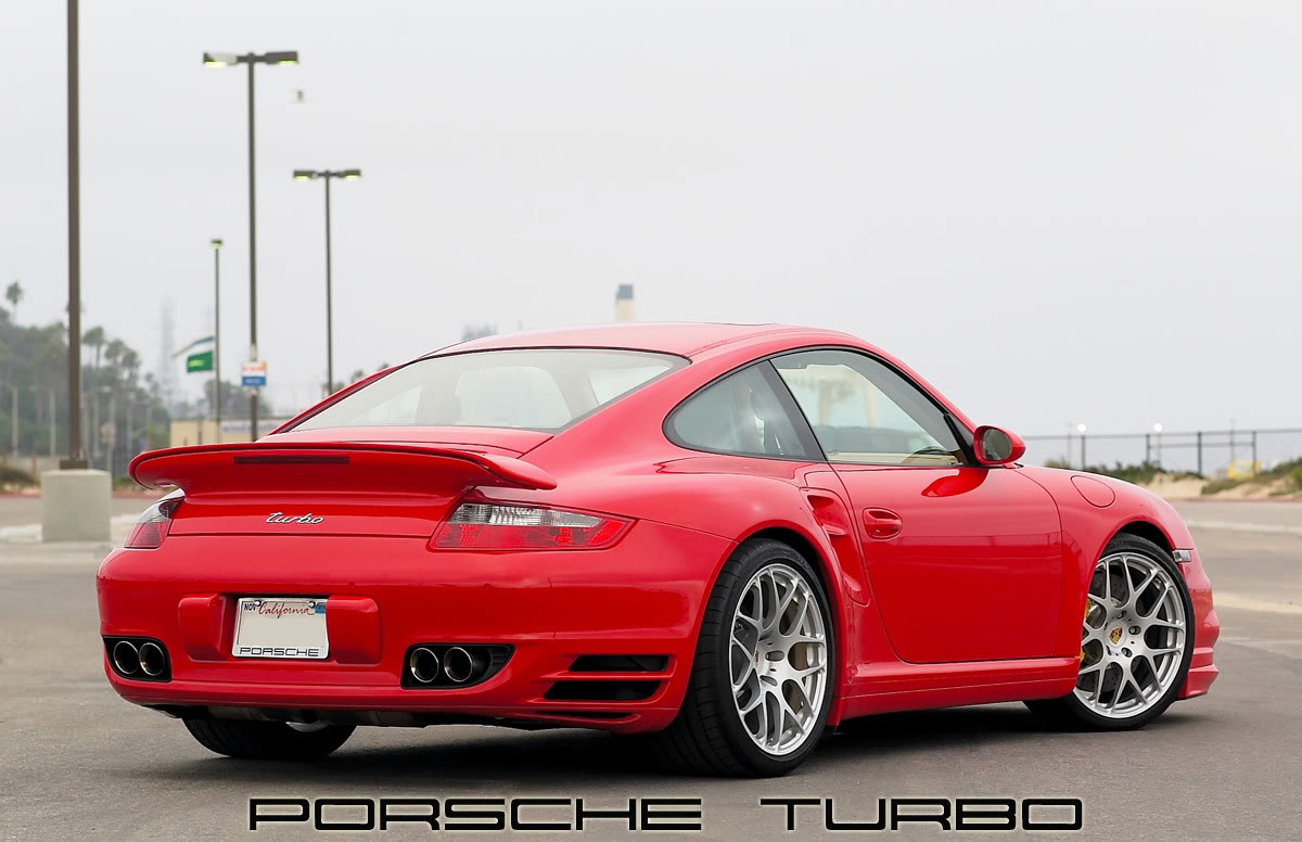

To OP: Besides the difference in ride, don't forget the weight penalty: Weight at the wheel means penalty with nearly every aspect of performance -- ride, handling, braking, acceleration, steering. There have been numerous discussions on this, but long story short: It has to do with linear and angular momentum, and the gyroscopic effect (precess -- look up Wikipedia). Mass at the rim is simply not a good idea.
With the P40 (I'm self proclaimed owner of world's first set of P40 btw -- only half kidding, I actually *am*.), 19 might be ok because the way the wheel is designed -- notice how the spokes are carried out all the way to the rim and how thin the outer rim is -- it looks bigger than its actual size.
For lowering, no question coilover allows you MUCH MUCH more freedom as far as how much you want to lower as the ride heights are variable, whereas lowering springs dictate a fixed height of around 1 inch or so. Go with Bilstein, like the majority of people here who mod the suspension. Here is mine, Bilstein, P40 19". At the time of this picture I believe the car was lowered around 12mm in rear, and 20 mm or so in front (nose down, derriere up LOL = beautiful rake angle; can't do this with lowering springs either):

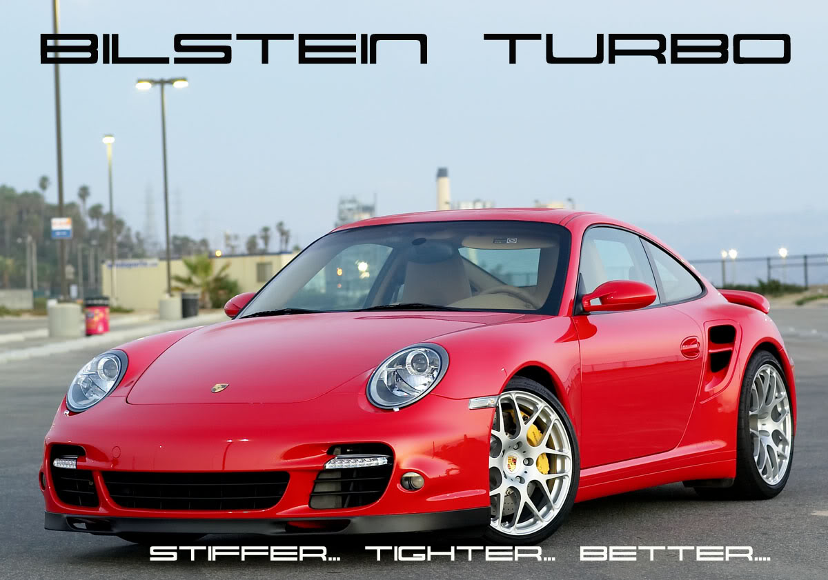

Here is shot of front of car:
