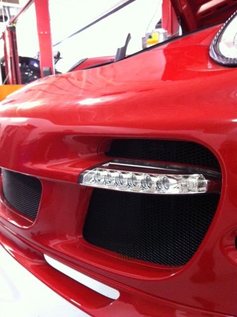

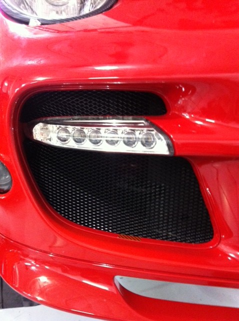

Originally Posted by forerunner
I've been wanting to remove the grill inserts(horizontal bars) from my front end but it looks like the inserts on the side intakes are part of the turn signal/DRL assembly.
Can anyone verify?
Thanks,
Nels
That is correct, Nels...so I cut mine out with a dremel.
Check out the pics.
Thanks,
cdw

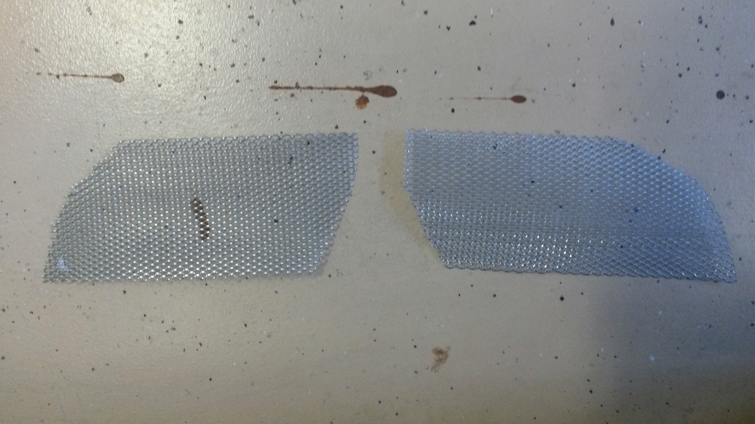

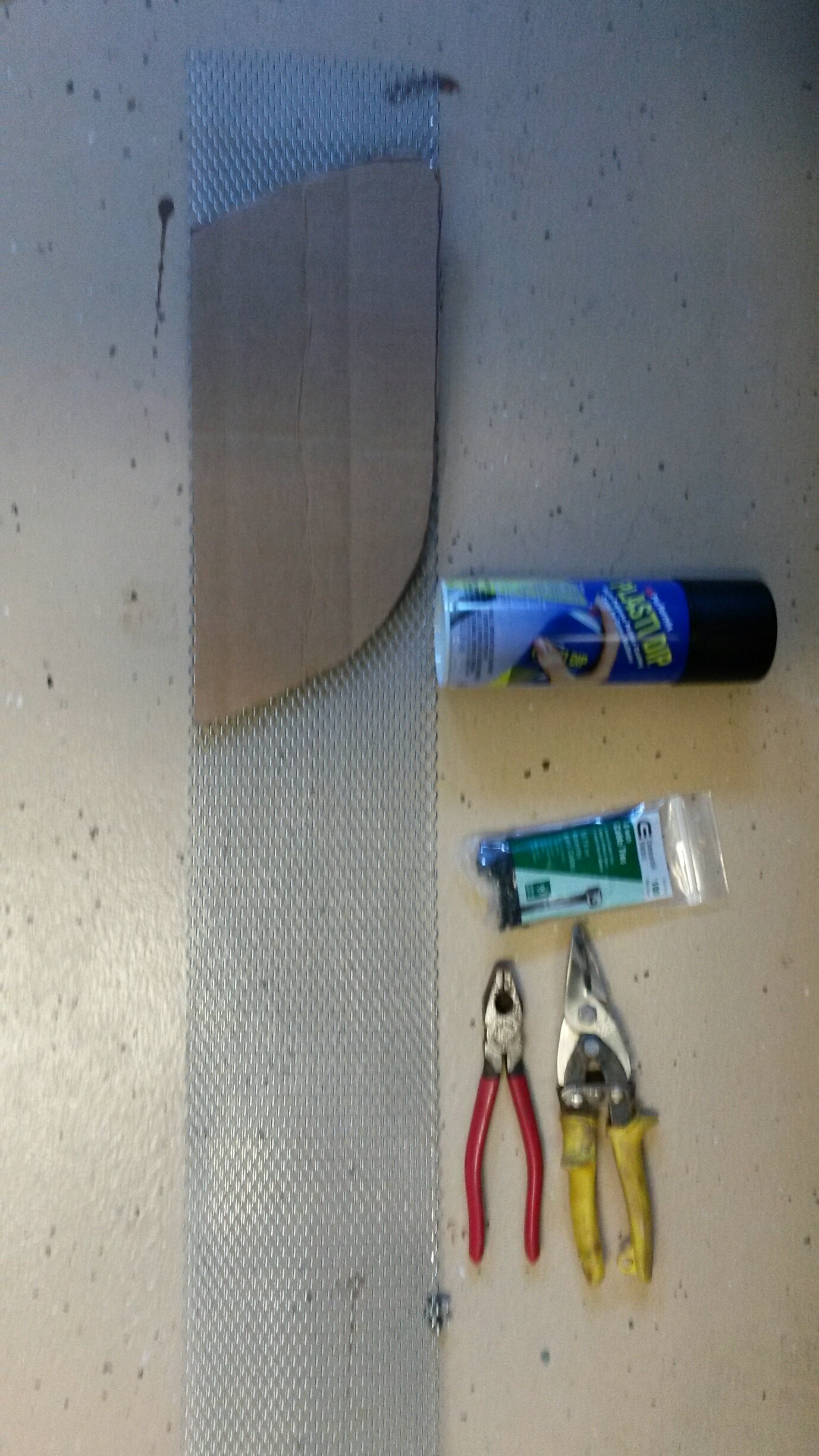

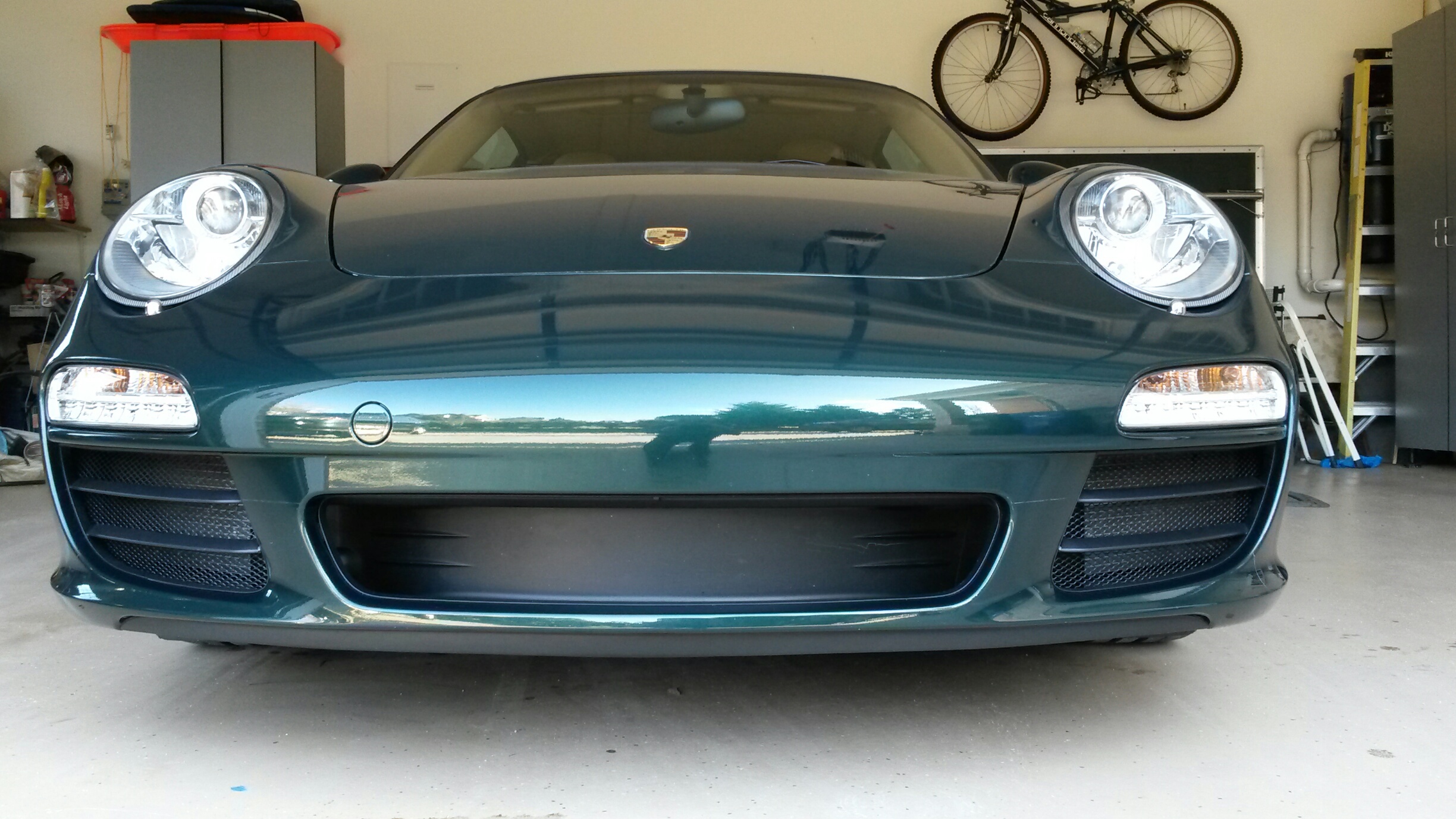

DIY Grill for only $9.00
Here is my first DIY with a lot of help from the forums. I was able to get all the materials locally at home Depot for just under $9.00. I wasn't ready to tackle taking off the front bumper so I installed the side grills from the back. I primarily wanted the sides done to help prevent any direct hits to the radiators. I am fine with leaving the center open so that I can go in there annually and clean out any leaves or debris. I also have the procedure on youtube . Took about an hour or so.
