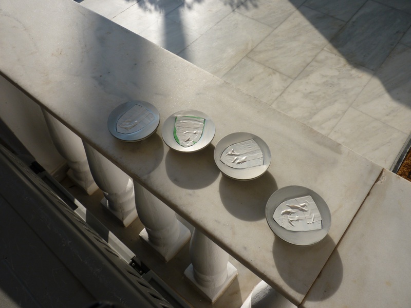

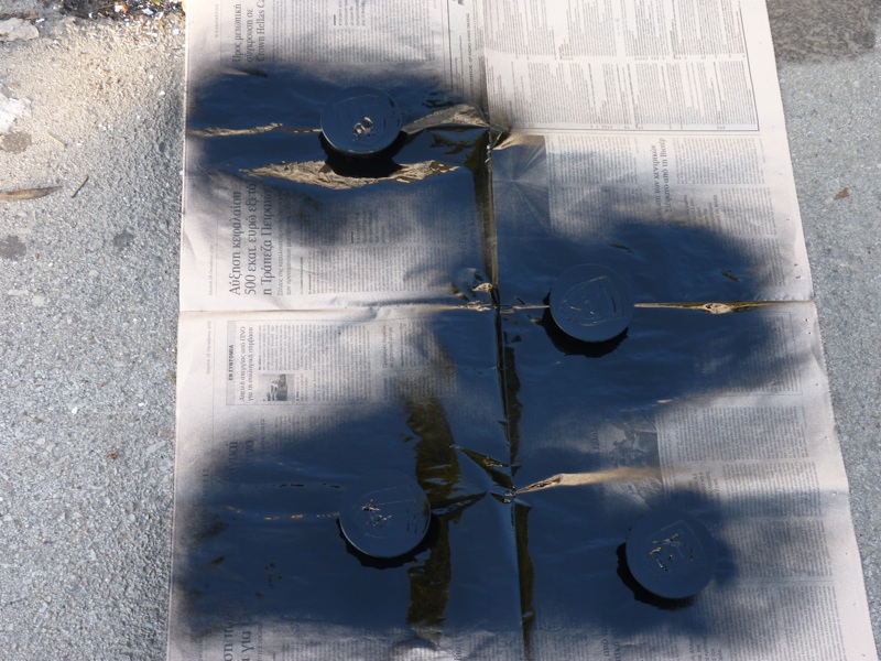

Here is the 30 minute deal on the center caps of the wheel (just done last week).
Take the center caps off, and lightly sand them with 600 grit sand paper (see pic with 2 caps, top one is sanded, so dont expect to see too much difference. Be careful dont touch the crest, the chrome is easy to scratch).
Carefully mask the P crest with flexible tape (so you can bend it around the curves, cut corners carefully with a blade).
Buy can of matte finish black paint and matte varnish.
Spray the caps from all angles from a distance of at least 30-40 centimeters and allow to dry for a couple of hours.
Then spray the varnish, or else it is likely that the matte color will scratch off. If you have patience, wait 2 more hours (or in KSA more like half hour!) and spray another coat.
Done. Install and drive off...
Attached are visual aids. Good luck. Its an easy project that the most time is spent on masking the crest, and it should not involve more than half hour work.
