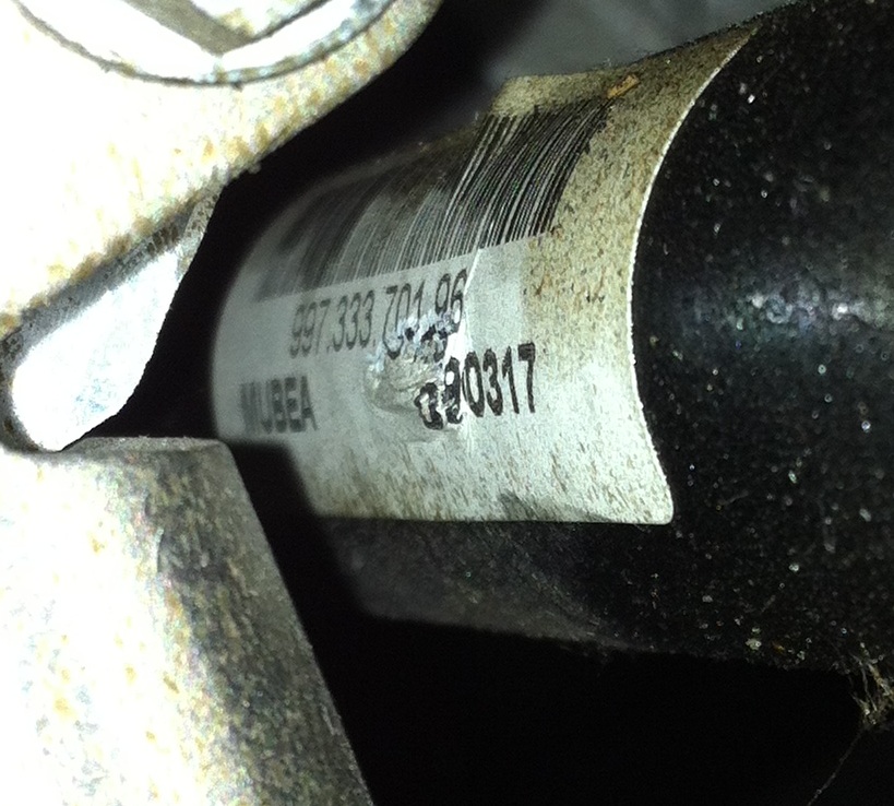

Reviving an old thread to clear some confusion.
GT2 rear sway on some parts catalogs will say: 997 333 701 94 - I believe this has only 2 settings.
But if you enter this number on Porsche's parts finder, it will say the part has been superseded by 997 333 701 96.
So, I crawled under my car. The part number on car is 997 333 701 96 and it has 3 holes.

Thanx Bobby, I also thought mine was two holes, but porsche covers the middle hole w black tape, not sure why. I believe the -96 bar is the g2rs bar.

Got it!
My car was built in 07 for the 08 year - and it uses the newer -96 number. I guess they had plans for the RS all along, or the RS is partially a parts bin project.
