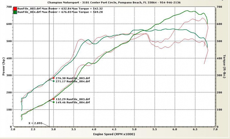

here's a comparo to "another tuners" ic
green CMS
red "other tuner"
This dyno says it all!!!
green CMS
red "other tuner"
Why would your power take a sudden drop at 5250 then steadily increase beyond that? At higher rpm, you're certainly not creatling lower IATs or better flow. It doesn't make any sense to me.
Me neither TT. It could be two different tunes, different exhausts, turbos and so on....who knows?? But it doesn't add up why the curve recovered after the drop at 5200. Maybe more than just ics in play here. To make a real comparison on IC performance all the variables need to be equal.
Not sure why, but this was happening on every run...the only different variable from my car to any other car with 68mm turbos build was ICs so this was the outcome when CMS went to theirs
It's one thing collecting data but it's another to interpret it. I'm not convinced at all from this data, that one can conclude the other AM IC is inferior. I think the better conclusion is that something very odd happened at 5200 that was systemic in the runs as opposed to an inferior IC. This result does not rule out the fact that they both can be excellent ICs.
The two dyno plots that Arone997TT posted were from his car, done last Friday, both within 1 hour of each other. The ONLY constant that was changed were his intercoolers. If you look closely at the graph, you can see that while hp may recover slightly, torque does not. I will have to talk to Louis to get a better understanding of why this happened, but I can tell you that NOTHING else on the car was changed. Same tune, same weather, same turbos, same everything....just different intercoolers, within 1 hour of each other.
timing coming out to quell detonation and then being fed back in would be my guess. people really need to start posting logs with dynos...
