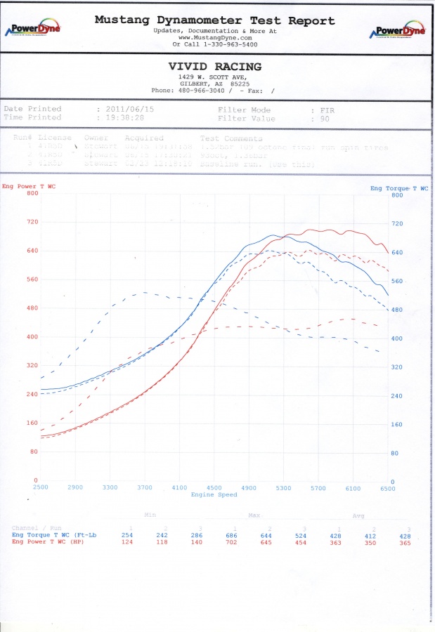

Alright... Update time!
We took on this project knowing what our kit could already do based on my 6spd car. But the underlying factor here was the tranny. The tranny needed to support the horsepower or the power would be worthless. After all our research online, we were going to go with the way all others do simply with using additional MB discs. But everyone is so secretive about what is done (keep reading, not that much of a secret). But instead we took on an opportunity with a company who makes DSG discs for other cars like the GTR. The concept as we talked about above was to add more discs and more material. Our problem with this really ended up with R&D and experience since we were here in AZ and the builder was not. Not afraid to be honest, we burnt up 2 sets just driving normally. This was because of spacing, not material we believe. So to not hold up the project anymore, we dove back into our research. What is in these tranny's from MB? Call Porsche, they dont know. Call Mercedes, "you got a VIN?". Making connections with the right people, we learned alot to build a successful strong Tiptronic tranny.
You really only need 5 things to have a successful Tiptronic: New Discs and Spacers, Solenoid Valves, TCU to increase line pressure, upgraded Torque Converter, and larger diameter line. Upgrading the K2 and K3 clutch baskets you have to order parts from a SL55 AMG. This includes new discs and new spacers which is key. You need 2 kits for 1 car and then it is all about measuring. If the spacers are to tall, then you have disks that will not engage and if they are to close, disks bind up and burn. The goal as we already discussed was to increase pressure and that is done with the upgraded Solenoids and a TCU flash while improving flow with a larger steel braided line. The TCU is really there to improve the shift points. With the pressure up'd, the clamping force allows for the increased discs to hold together under peak torque. We did not upgrade the valvebody. Will post pics of the upgraded parts later. We are going to re-investigate the Kevlar disc upgrade though, no eta right now.
So the results...
We strapped the convertible down to our Mustang AWD dyno and with the existing 93octane the car had, we begin to do some runs. Granted it is 100F in the room, we were expecting some ok numbers. First we wanted to run wastegate pressure only. This was about .9bar. Once we confirmed the car was running ok, our set goal for "pump" gas was 1.35bar We did 2 runs back to back and yielded about 650awhp. The Mustang Dyno in AWD mode is called the Heart Breaker or Dream Killer because it usually shows a 20-25% drivetrain loss. That right there is about 800 crank. We did a couple more runs at that boost level to make sure the tranny was still holding up. Our next goal was to set a race boost level. This was going to be 1.6bar on 109octane. So we slightly dialed in the boost and made run after run as we crept up. Letting the car cool for an hour, we came back to do the glory run.
With traction control on, we let it rip in 3rd gear. At 5200rpm with traction control on, we were still breaking loose the tires. With peak boost only hitting 1.52bar, the dyno correction factor had it putting won 788awhp and 762ft/lbs of torque!!!! We were not able to get the tires to stick anymore. In cooler temps and 1.6-1.7bar, this car is making 850awhp easily In comparison, my 6spd car made 760awhp and 690ft/lbs of torque on 109 at 1.7bar. The difference is the 72lb injectors, 4inch compressor inlet on the GT3076 turbos, and the Tiptronic. The car came to us with a flash, AP Exhaust, AP Headers, and AP intake. It gained over 250awhp! So yes on the dyno, the car felt good, but how would it feel on the street? Next Post coming up....
Reference for Greddy Boost Settings:
Low Boost - Dial 60%, Gain 18%, Set Gain 23%
High Boost - Dial 80%, Gain 18%, Set Gain 23%
Dyno showing Baseline, Low Boost, High Boost
