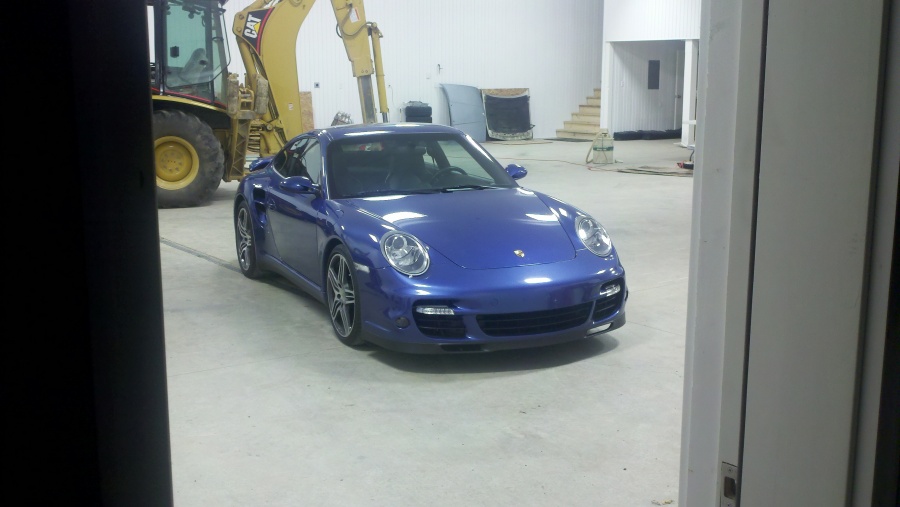

Hello all,
I am having a problem with my new/used 997 Turbo. I bought the car with about 6000 miles on the clock and it is now up to about 10,900; so still a baby. I do have the extended warranty until 2012 and want to get this problem figured out soon so if it is something big, I’m not left with the total bill.
