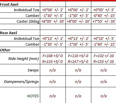

here is a very basic chart for 997- from left to right for-- GT3-GT2- TT
Old Jul 8, 2011 | 10:08 PM
  #38
jdavis911's Avatar
Joined: May 2011
Posts: 76
From: Edmonton
jdavis911 is infamous around these parts
Thanks for the help Sal, those numbers look good.
