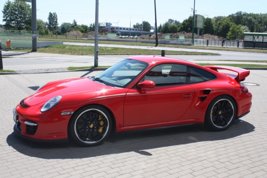

I have my sights set on two cars roughly at the same price point.
2008 GT2 Guards Red w. 25K miles on the clock or
2008 Turbo Black w. 20K miles on the clock
I understand from reading up on several threads in this forum that the Turbo will be the more comfortable car whereas the GT2 will feel more light and precise performance orientated. From this description alone I would go GT2 but I'm a bit worried if I'm going to have leg cramps every time I end up in traffic and pee blood after I ride on poor quality asphalt.
Lastly I'd appreciate some feedback on performance mods. From browsing different tuner pages I understand they can achieve around 620 crank HP for both models with a simple tune and that I can pick up another 20-30 HP if I go with a full Europipe (or similar)
Will both the Turbo Tiptronic and GT2 Manual gearbox handles this power/torque? Or should I expect slip and therefore be forced to upgrade the gearbox?

GT2 - much, much firmer ride (normal setting is like the Turbo with PASM on), more precise steering and feedback, lighter, more turbo lag, more aggressive in stock form, lower, more aggressive appearing, easily modified (both are), ceramic brakes, appears to be built tighter, no sun roof, and adjustable suspension. Mine is a DD and the clutch (stage 3) is fine with little effort in traffic (though it is no PDK). My car is making about 640hp crank with more than 700tq and it is very drivable.
Turbo - made to be softer and appear to a larger segment. My turbo had over 600hp and 600tq and was nearly impossible to get into trouble regarding getting out of control with its 4-wheel drive. Clutch is very soft. It was an '07 with a 6-speed.
You need to drive both of them, not just listen to what people have to say - it's very personal (I'm sure you know that). What I can't understand is how you found a GT2 and Turbo at nearly the same price. The GT2 should be getting between $120-130 depending on OEM options and the Turbo should get around $80-85 (IMO). If the GT2 is that low I'd get a PPI and thorough history. Just my 2 cents.

The GT2 hard clutch will get very tiresome in heavy traffic, but the suspension is hardly harsher than the turbo (both being in non-sport), so no blood in the urine. I prefer EVOMS ecu tune and you dont need a full exhuast, just get some 200 cell sport cats and that will give you the extra 30hp. My clutch did start to slip after the mods and so I got a stronger and ligther fly wheel which makes everything better.
I think if you drive them both you will chose the GT2 based on what you are wanting.

From a 599, I'd go for the GT2. Its a very comfortable drive and the clutch isn't too heavy. Our roads are generally horrible but its not a big deal driving the GT2 every day. My clutch starting slipping the first day I loaded the tune (Switzer) and I've had it upgraded since then. The tune itself added 32whp and that is my only performance mod.
The GT2 has much more of a presence on the road and is a great car, minus the ****ty stock clutch.
