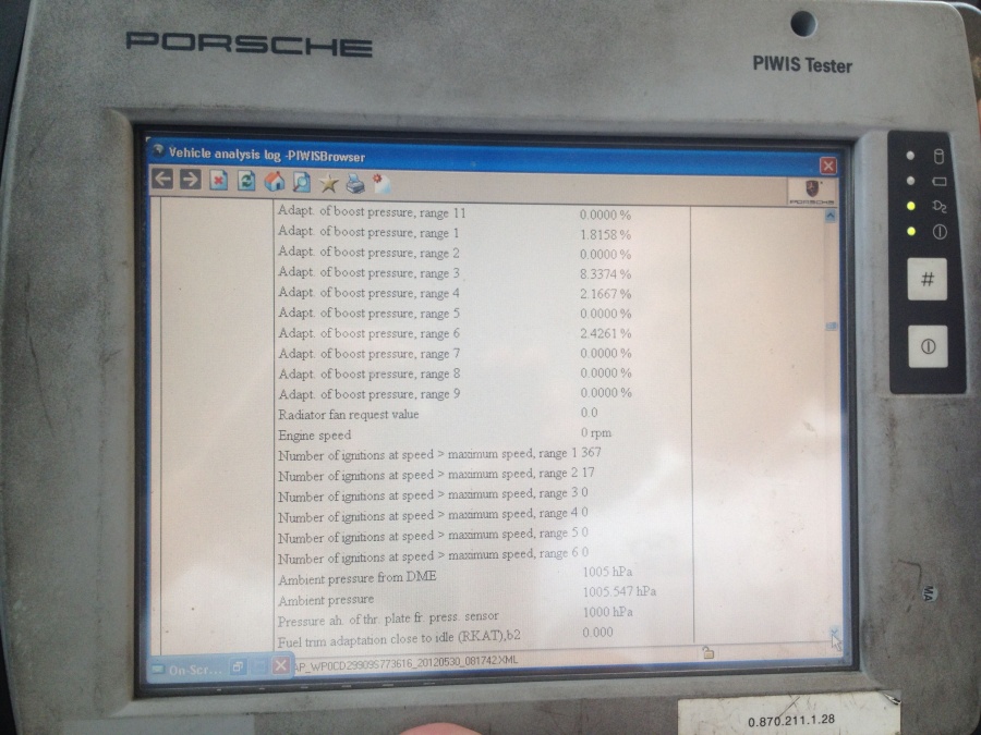

Considering buying a 2009 Porsche Turbo Convertible. I was able to request the DME scan, copy of CPO checklist and Car Fax report. All attached. Car currently has 34000+ miles. A few questions I would like your help and opinion:
1. Results of the DME scan indicate:
Number of ignitions at speed> maximum speed, range 1 367
Number of ignitions at speed> maximum speed, range 2 17
Number of ignitions at speed> maximum speed, range 3 0
Number of ignitions at speed> maximum speed, range 4 0
Number of ignitions at speed> maximum speed, range 5 0
Number of ignitions at speed> maximum speed, range 6 0
Anything to worry about with this DME scan report? Is there any information missing on the DME report?
Any information that should be provided besides attached.

I assume its a tiptronic? Very few over-revs... must have been a really passive driver...
Funny I thought the time (hrs of operation) was listed next to the ranges.

It is actually a manual transmission car.

1. that DME is perfect, zero to worry about.

Car was basically taken to redline once in a blue moon and that's it. Driven by a grandma

It looks good...however to be 100% sure regarding miles/hours of operation i need to know operating hours of the engine and total mileage of the car...Also when you read Vehicle Data at top dme segment of piwis it shows you the exact operating hour of the engine that the last ignition spark occured for that specific range of RPM...the data you provided are from Vehicle analysis log.On a different page of this analysis engine hours and exact hours of each last spark are shown...If you ve printed out that log do a search for these data...
