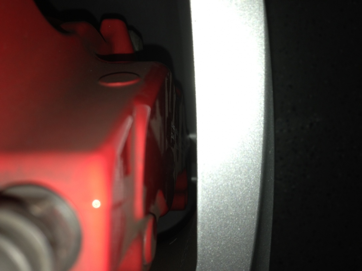

test fit some champ wheels. It clears the caliper by about 10mm. Enough?

10mm should be fine. We have seen closer. Fitment looks nice - very flush to the fender.

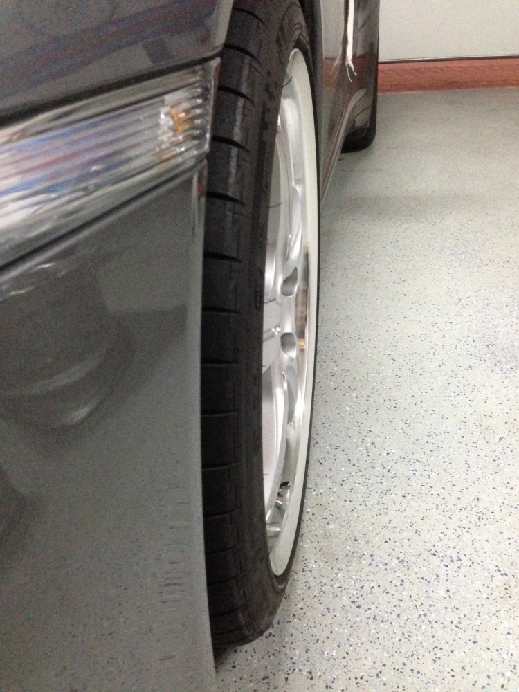

w/ the exception of the front side, they are pretty much flush. I like the way it looks, however a slightly lowered stance would look letter. The weight vs the stock turbo (forged) wheels are noticeable in my hands!
Now Im off for a agressive, street, alignment. thanks!
