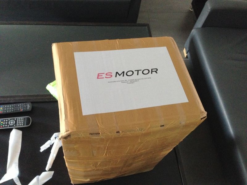

3.8 stroker and camshaft are on the way...

some photos:
head gaskets
Pistons
Camshafts
Head studs
