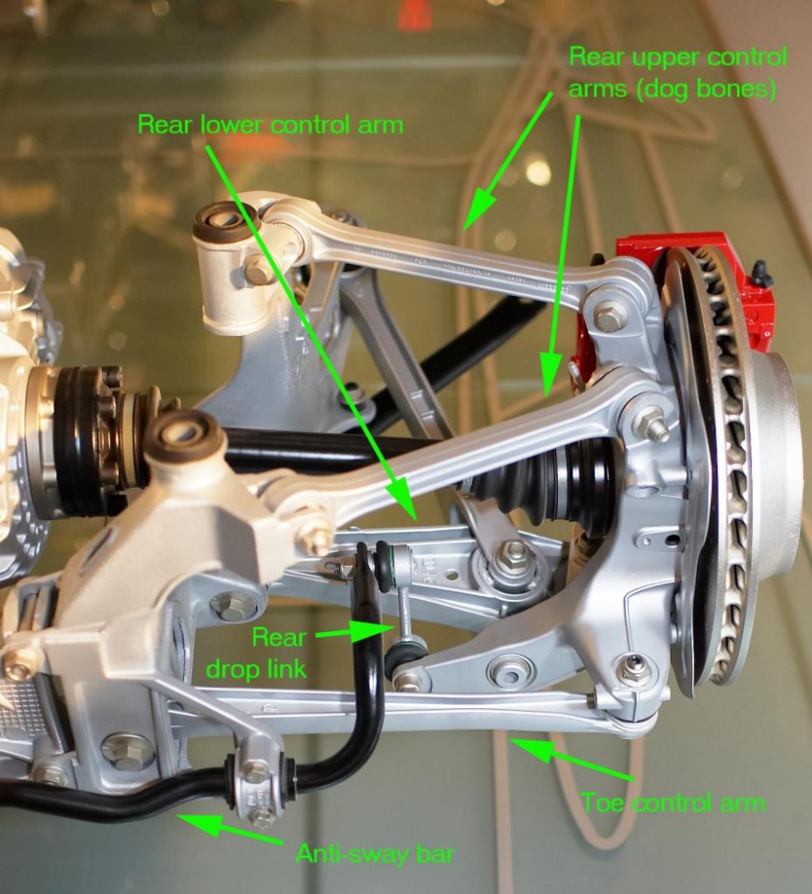

drsullivan, very pretty :-) ; congrats and hope you will have a lot of fun with the toys!
For anyone interested, picture of the links in actual suspension - yummy stuffs :
Thx...love the pic

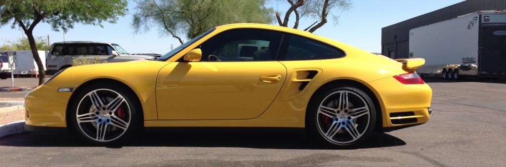

I dropped the turbo off at Evolution MotorSports yesterday! Looking at having their SSK installed as well. Good times.

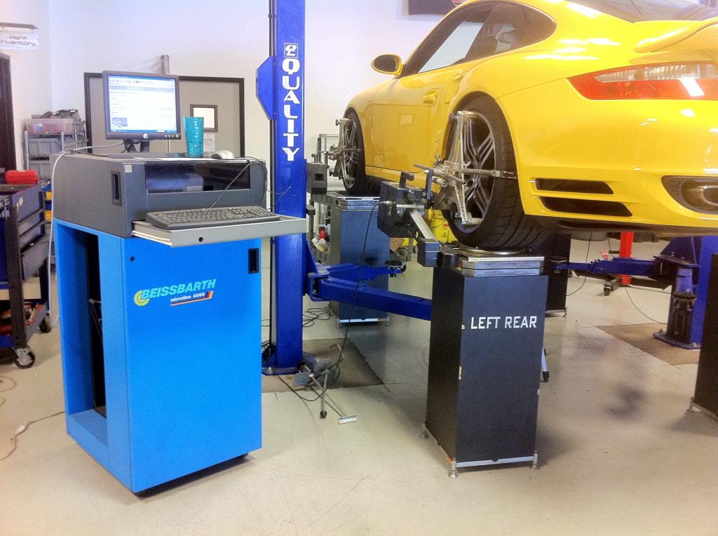

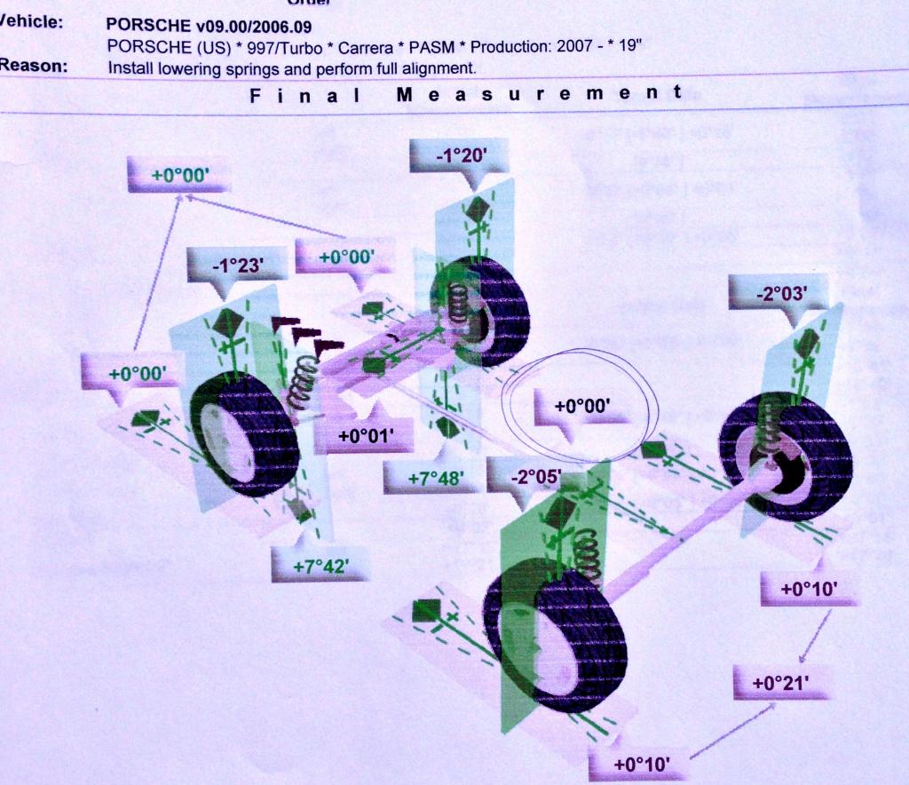

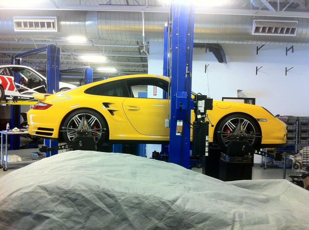

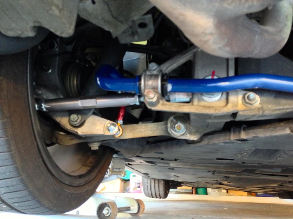

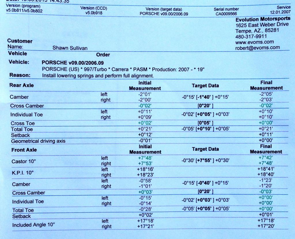

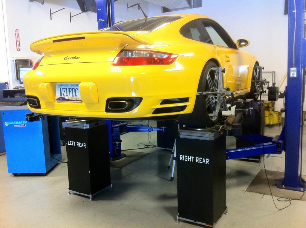

Big thanks goes out to Robert Boreham at Evolution MotorSports in Tempe! I picked up the car tonight and he went over everything he did in detail. All-in-all this is what was accomplished: Tarett rear drop links, RSS rear toe/steer kit, GMG sway bars and springs, and EVOMS SSK.
The ride is more planted, firm, predictable, sharp, fun, flat, and feels absolutely GREAT to drive!
While not the same as my past GT2 it is a far cry from the stock turbo. I've included pictures of the alignment machine EVOMS uses (same as the one in the Porsche factory) and before and after as well as some of the goodies making the rear suspension better.
before (outside EVOMS awaiting surgery)
After (in my garage...those are baby pics of my daughter...now 22)
Up on the alignment machine
Some suspension pieces

Cann, thanks for that awesome pic of the suspension.

Rear camber set at -2 right?
Did Evoms tell you what the max value that could be set for rear camber with stock links? Was -2 to the max possible?

I think enough time has passed for the springs to settle at their lowest position.
Originally Posted by cannga
Congrats - quite a transformation isn't it?
Thanks...it is a different car! I sent a text to Robert at EVOMS so I'll post an answer about the camber when I get the info.
Bogg ur welcome.
I'm told with my stock parts > -3 is achievable, hope that helps

^^^ Yes it did help, thanks.
I didn't know what rear camber limit was for stock car, and didn't expect it to be that high (-3).
I remain convinced that the heart and soul of a Porsche is handling feel and therefore suspension mod is the number priority in our Turbo, to get rid of the body lean and overall "mushiness." For those on the fence, don't hesitate, JUMP. It is guaranteed to be a transformation and there are plentiful data on this forum that the solution is simple and proven.

Re the rear camber, -3.0 is very doable.
