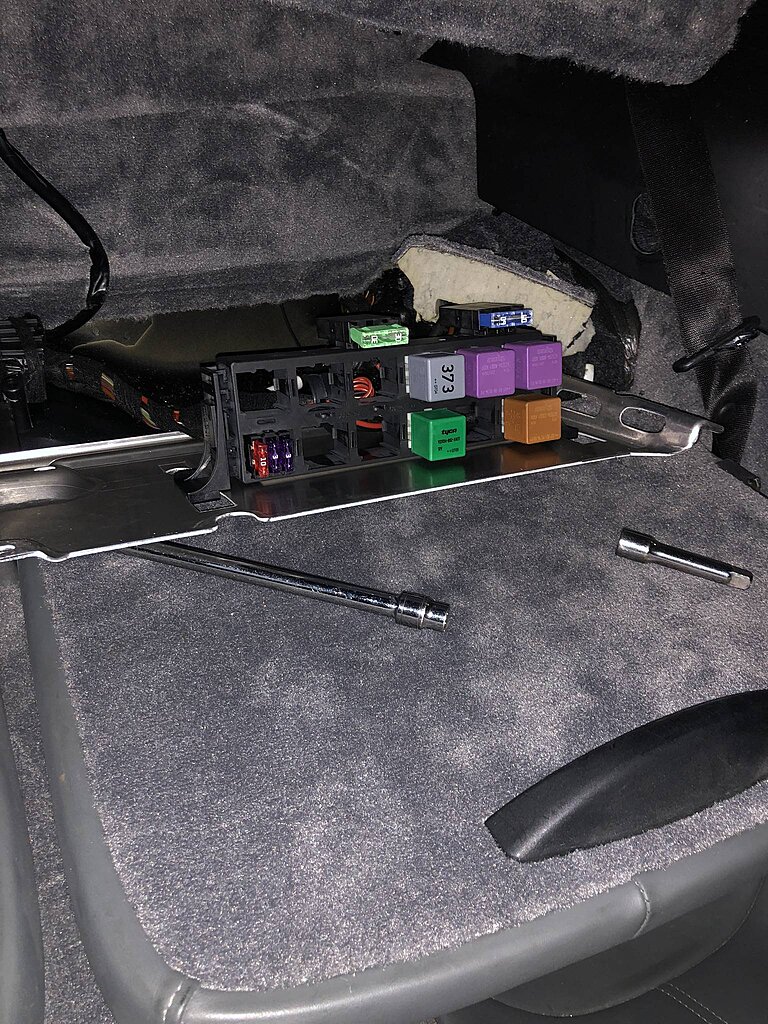

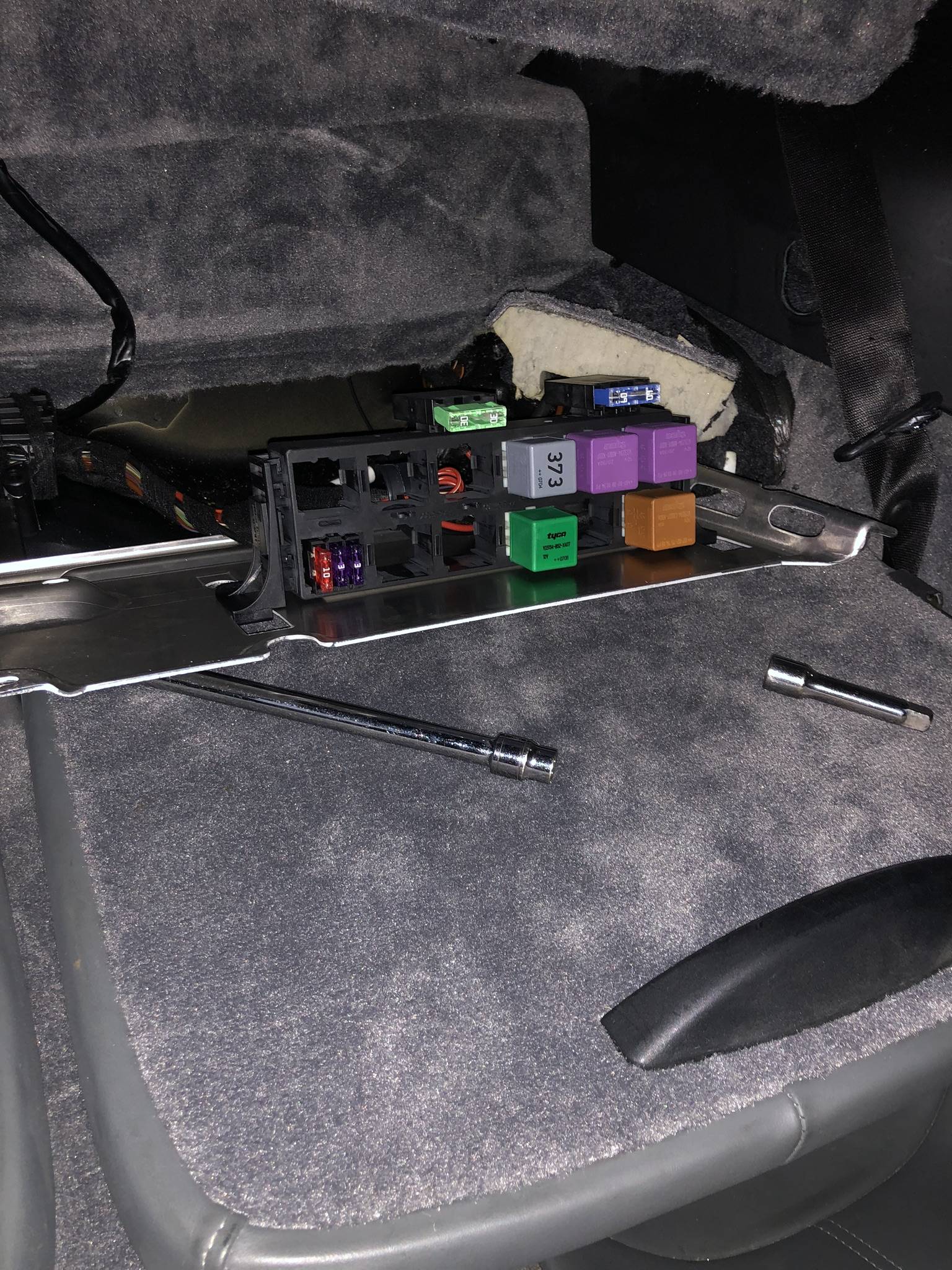

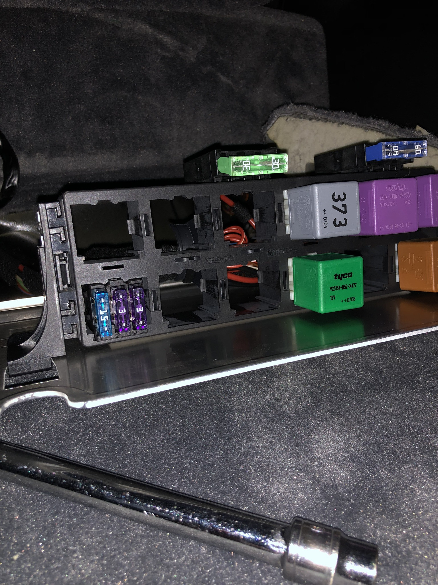

There were two mini fuses, one 7.5A and one 3A. Both were blown and I replaced both. The workshop manual lists only one 15A mini fuse in the rear. So if the fuse blows again, I'm going to replace the 7.5A with a 15A fuse.
Revised notes:
Here are the steps I followed to remove the rear subwoofer. Follow it all the way until you remove the metal plates. The fuse is located below the right metal plate (the ECU is below the left metal plate): http://sharkwerks.com/porsche/techni...2-and-gt3.html
See attached images, the fuse highlighted in red represents the blower fuse. The workshop manual says this must be 15A, but the car came with 7.5A. As Thackl mentioned, if this blown again, I'm going to replace it with a 15A fuse.
Does anyone know what the 5A fuse next to it (highlighted in yellow) is used for?
Overall, this is not a bad job. 20 mins max.

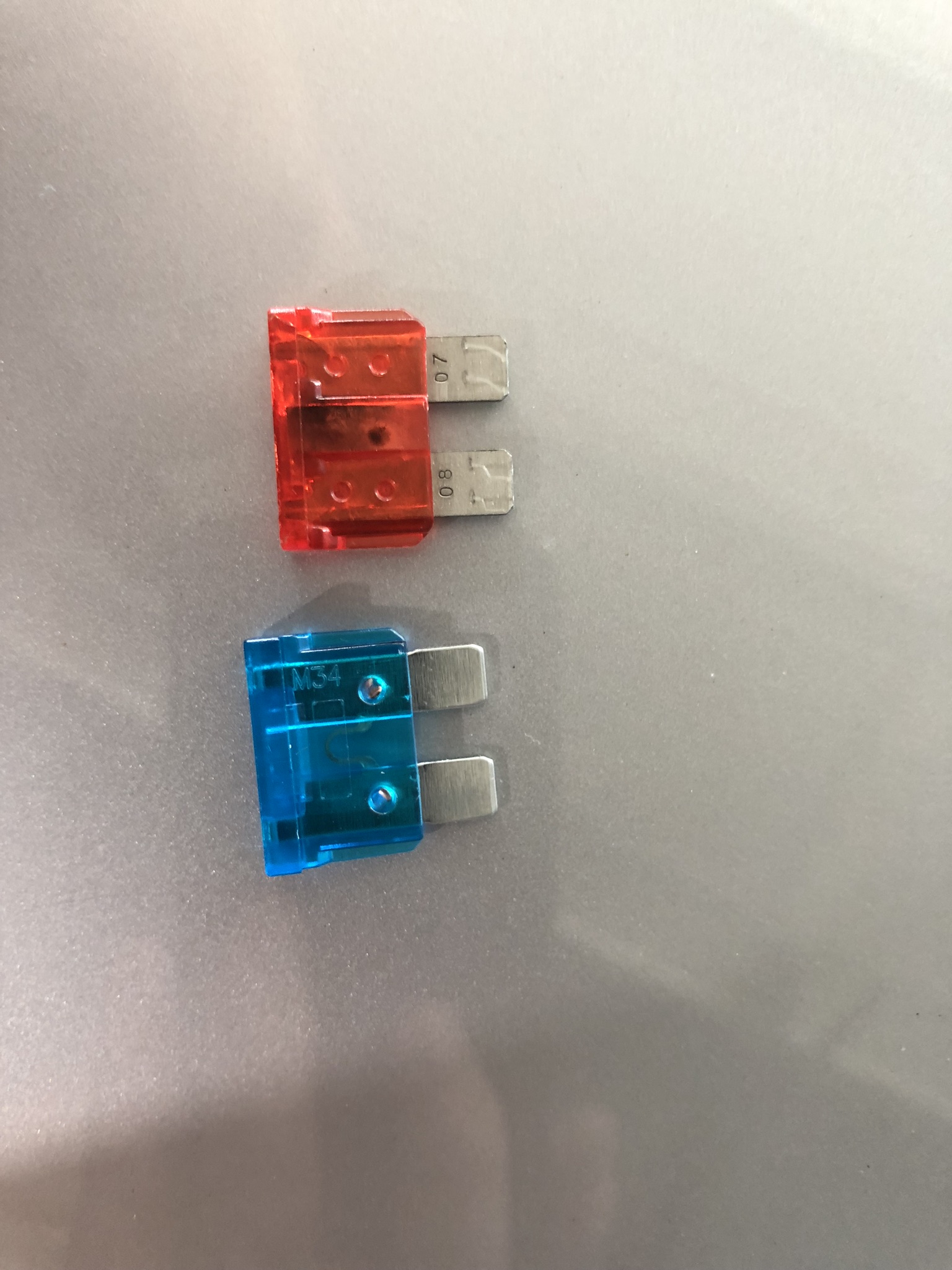

I wanted to bump this thread because it helped me fix my error light. I already had a 10A fuse in that spot on my 997.1 turbo, and according the version of the manual that I have, Porsche actually recommended to change the 7.5A fuse to a 10A. Well, the 10A fuse was busted so I fitted a 15A fuse and now the fan works great and there is no more error light. Not sure if there is a newer version of the manual that calls for a 15A fuse in that spot.
Concerns:
Fuse for engine-compartment blower (fuse F1 / relay compartment 6 / relay carrier 2).
Information:
Before programming the DME control unit, the previous 7.5 A fuse for the engine-compartment blower must be replaced with a 10 A fuse.
Reason:
With PIWIS Tester software version 20.000 (or higher), speed setting 1 of the engine-compartment blower is deactivated in the DME programming. This
can result in a higher power consumption when switching on the engine-compartment blower and therefore requires a fuse with a higher current rating
Production Period:
4th December 2006 to 8th February 2007
Action Required:
Insert 10 A fuse on relay carrier 2, relay compartment 6 (in area of rear seat assembly) in slot F1
Work Procedure:
1. Remove rear cover and relay carrier, --> Workshop Manual '979009 Removing and installing relay carrier'.
2. Replace previous 7.5 A fuse with 10 A fuse.
3. Reinstall removed parts

I know it's an old thread, but thanks anyway. Finally my engine compartment blower is working again
Old Aug 11, 2019 | 01:18 PM
jeebus31's Avatar
Joined: Apr 2018
Posts: 36
From: IN
jeebus31 is infamous around these parts
Sweet. Mine is going on 3 months, no issues so far. Fan is always coming on when I park it in the garage after driving it in the TX heat.
Did you use a 15A fuse?

Relay compartment 2, F2 is for low speed blower operation. It will throw error message and blink red temperature gauge LED. No error code was detected by Durametric. The activation section provides low/high blower testing (both test are called the same).
