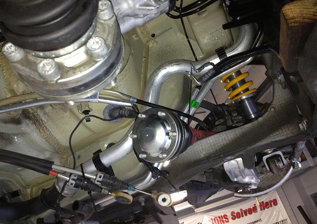

Cannga,
Tranny is out...no better time then the present to upgrade!
Numeric shifter will be installed by the end of the week. However, I have opted to go with 996 CUP Cables! As well as lots of 999 Porsche Motorsport Clutch & assembly parts.
Couple all this with an Aasco Aluminum Fly Wheel & GMG tranny urethane mounts. Hopefully this will prove to be a recipe that can handle the rigors of real track work.

Originally Posted by VID997
Cannga,
I had the Aasco on my 997TT - it's a little noisy, but revs matching is very easy.
