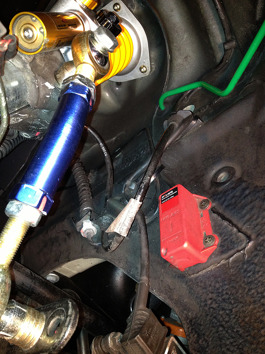

I am looking to mount my wired AMB Tranx 260 transponder and I am trying to determine the best place to put it on my 997.1 TT.
I know that is needs to have a direct line of sight to the ground and be placed towards the front of the car for optimal use, but I am not sure on location. Someone mentioned inside the wheel well, but I am concerned about that because of road debris and/or hard cornering and bogging. Any suggestions (pics preferred!) would be greatly appreciated! Thanks!
-Sayajin

See Posting #415 at the link below:
https://www.6speedonline.com/forums/...re-11s-28.html
I have it mounted on the inside of the drivers wheel well, toward the foot well. Then I ran the wiring through OEM holes in the body for the ABS system. Then I did a pigtail quick disconnect to the battery with a isolated fuse protector.
I'll see if I can find a better pic for you...

Ah...the beauty and instant gratification of an iPhone : )
Here you go!
