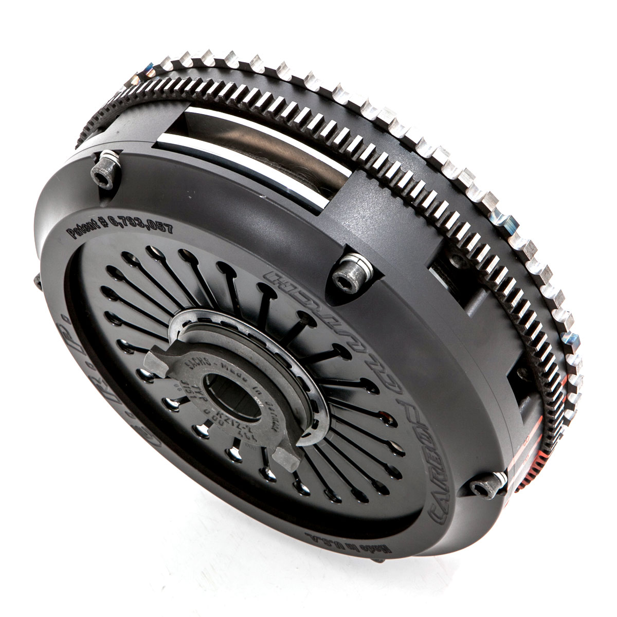

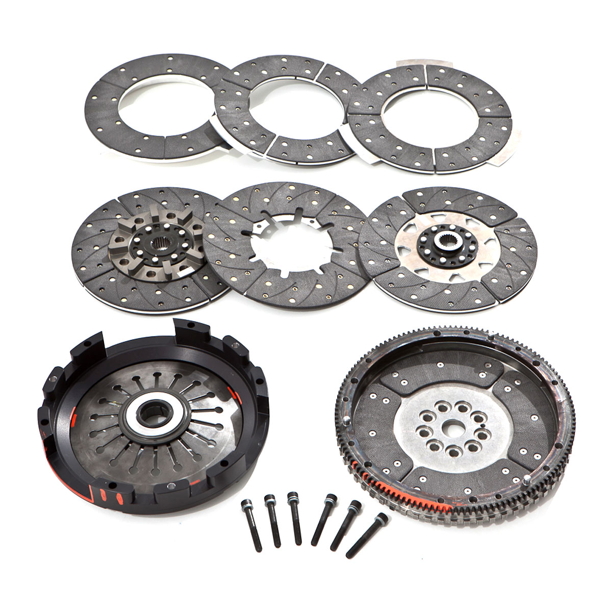

I don't think it's been added to the site yet...
Here's a couple pictures...
ID:	286650   Click image for larger version

Geez, talk about a "Simple Design" Do you think that this setup will take to fun out of the 6 speed for drivability when comparing it to the Sachs 2.5?
If you do the GT2 master/slave cylinder conversion then no...it will not.
But...like I said earlier, if you don't plan to go over 600whp...then the Sachs is the better choice, purely from a drivability standpoint.
