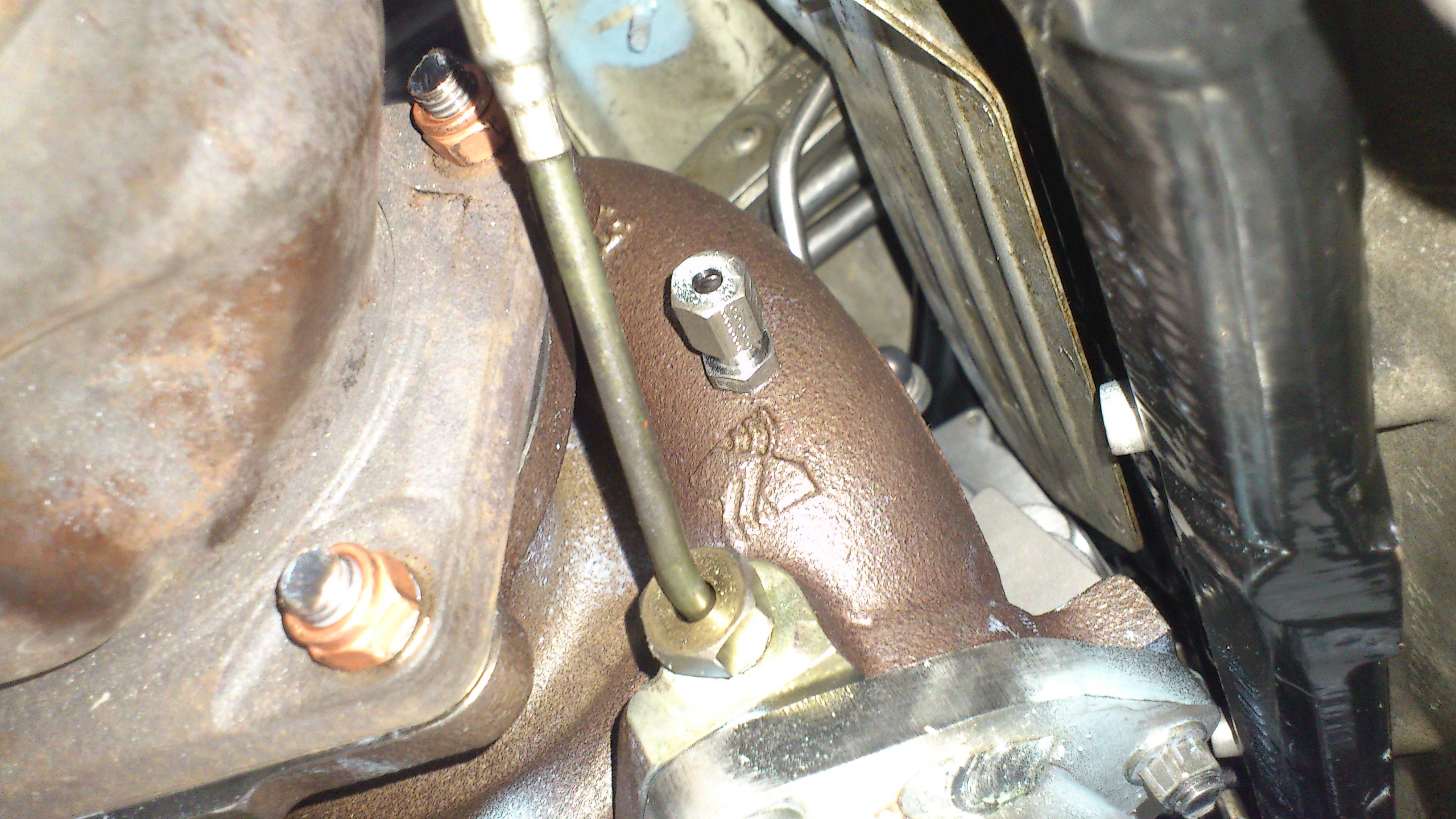

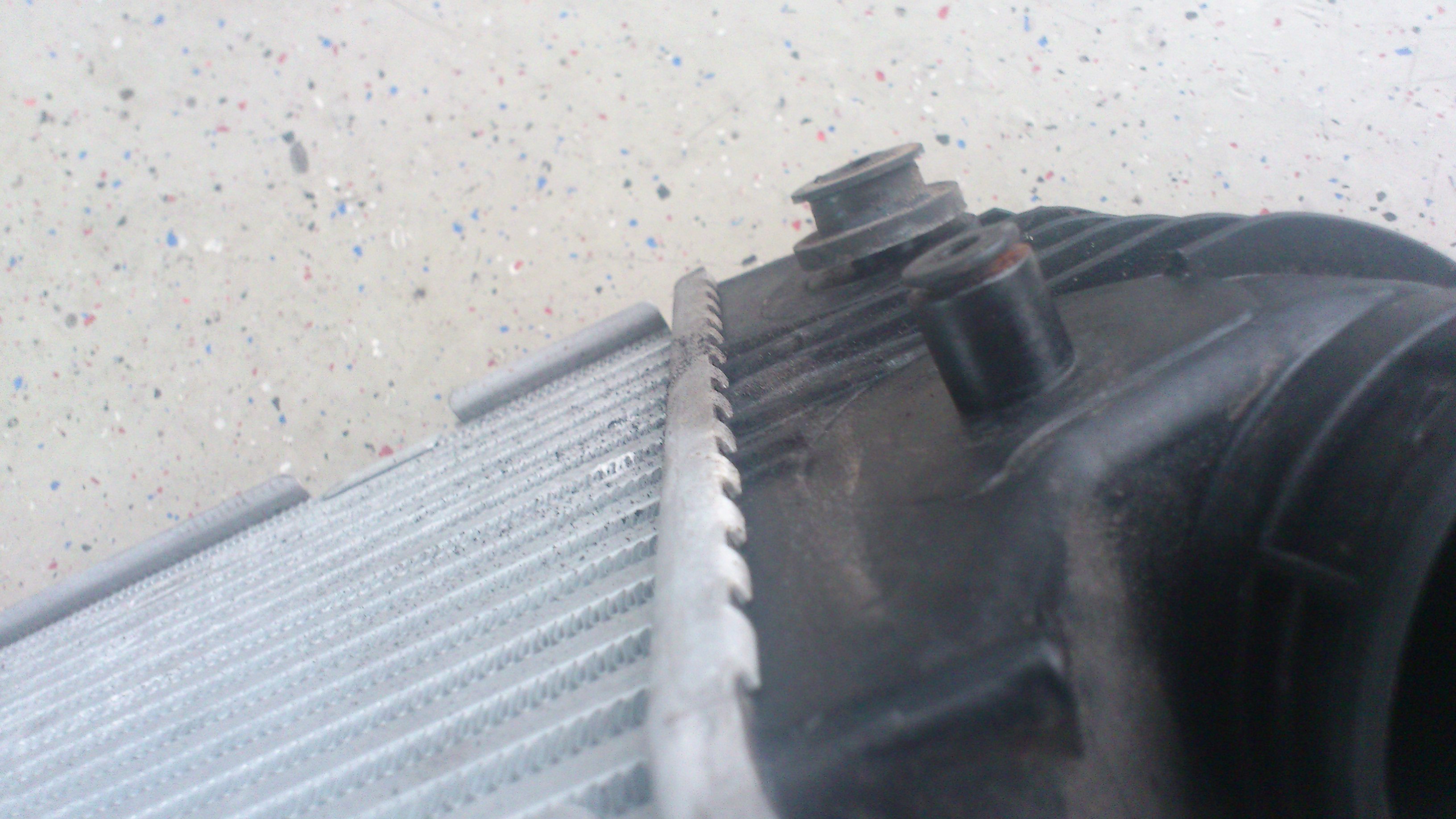

Hello,
i have test 3 Versions with other compressor wheels, the exhaust side is GT2
My experiance is the problem is the exhaust side, you can give pressure from 1,7 bar ore more at 6700 rpm but the power goes down, the exhauspressure goes over 4 bars, the oem Gt2 exhaust side can to 700 HP when the rest from the engine and cooling must very good condition.
my new engine i will test with upgrade Gt2 VTG Turbos but i think not much more power at the end of rpm

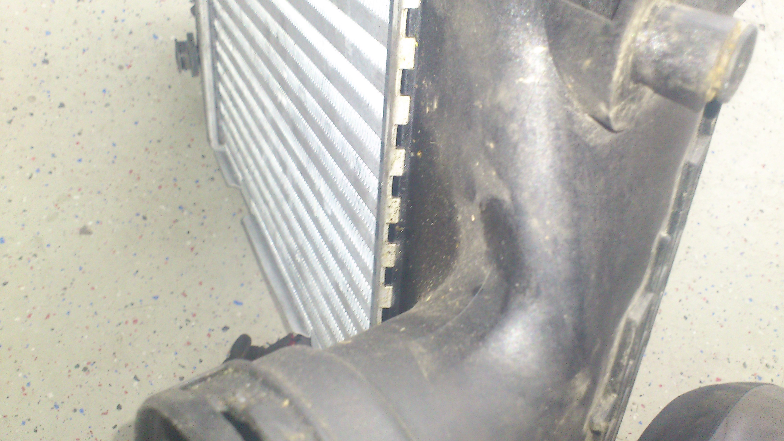

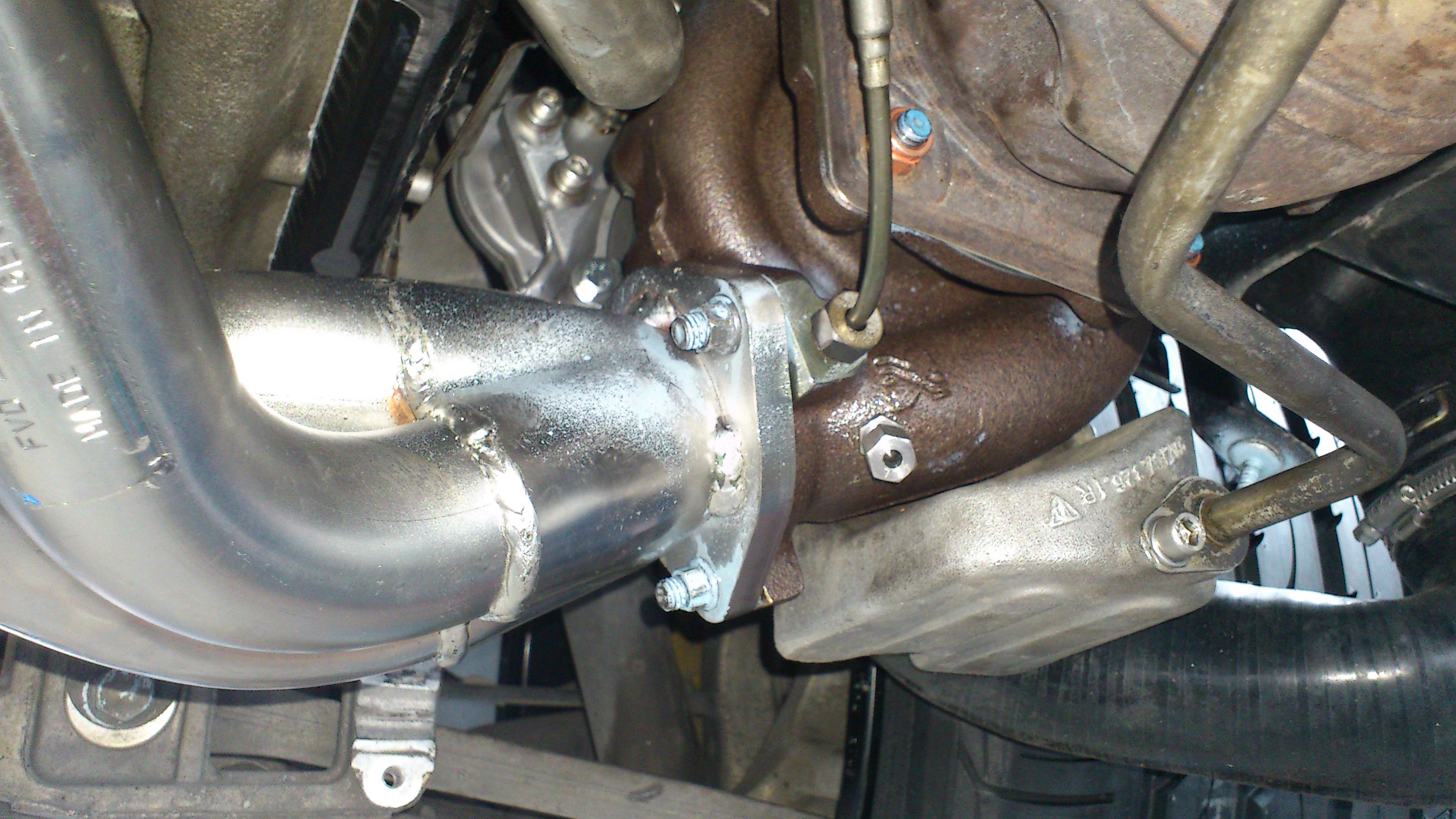

here further pictures from the nipples exhaustpressure and the other from the gt2 RS cooler with to much pressure
