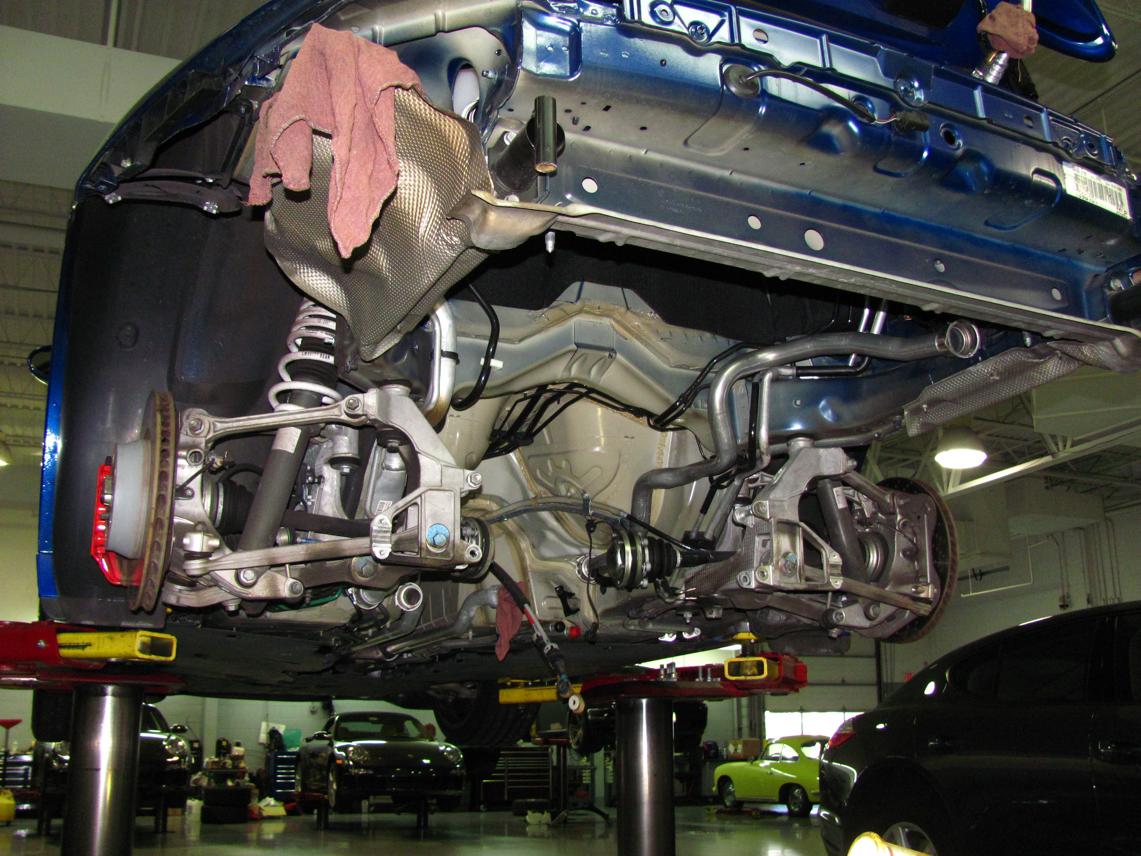

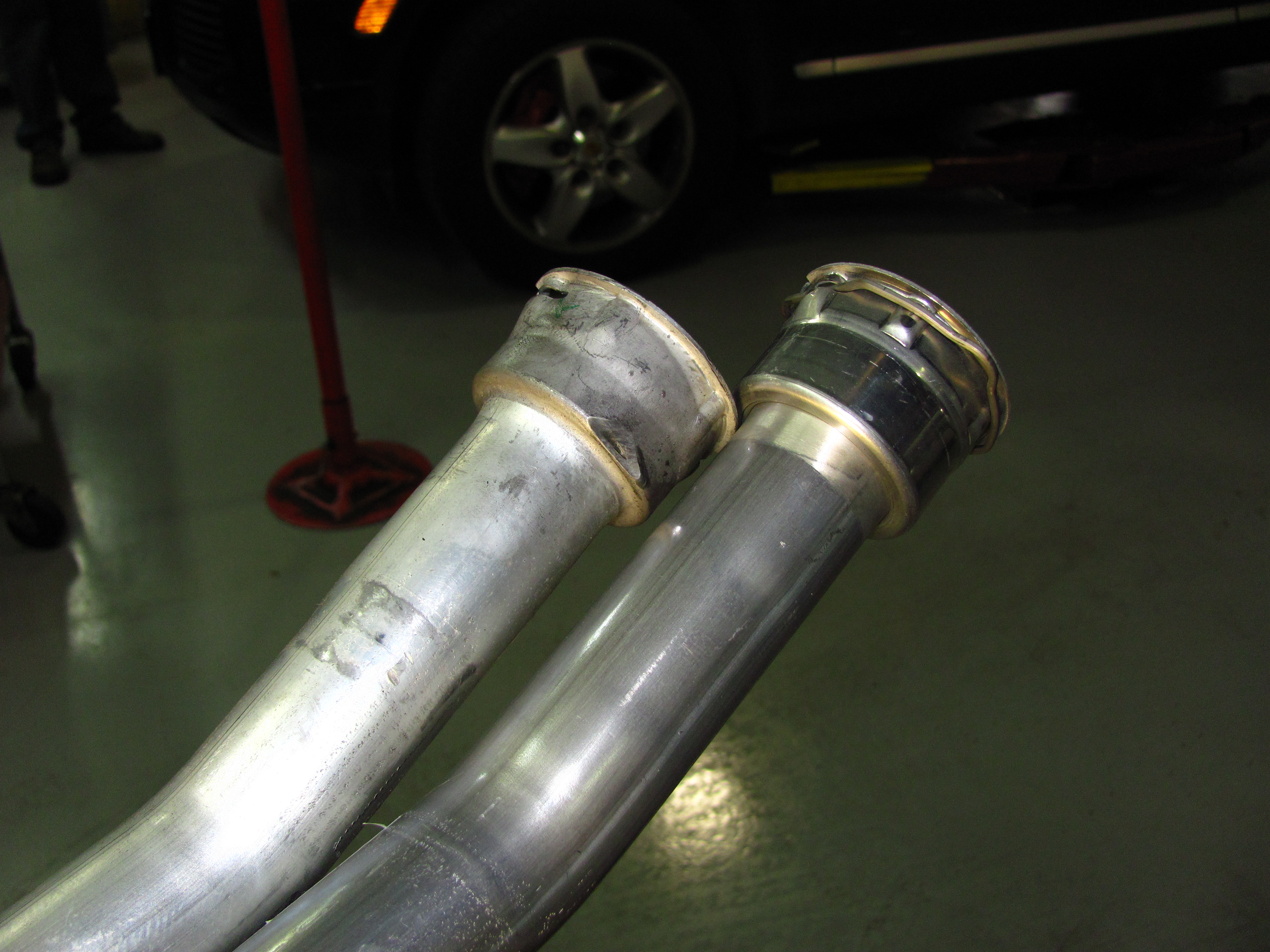

After about 4 hours the dealer called with "the news", My coolant supply tube 997 106 610 31 had been rubbing against a piece of shielding and wore a microscopic hole in the mounting flange (see pic). Unfortunately my decision to make an appointment for the day after Christmas was my real mistake . Due the holidays they would not be able to get the part until Jan 2nd.

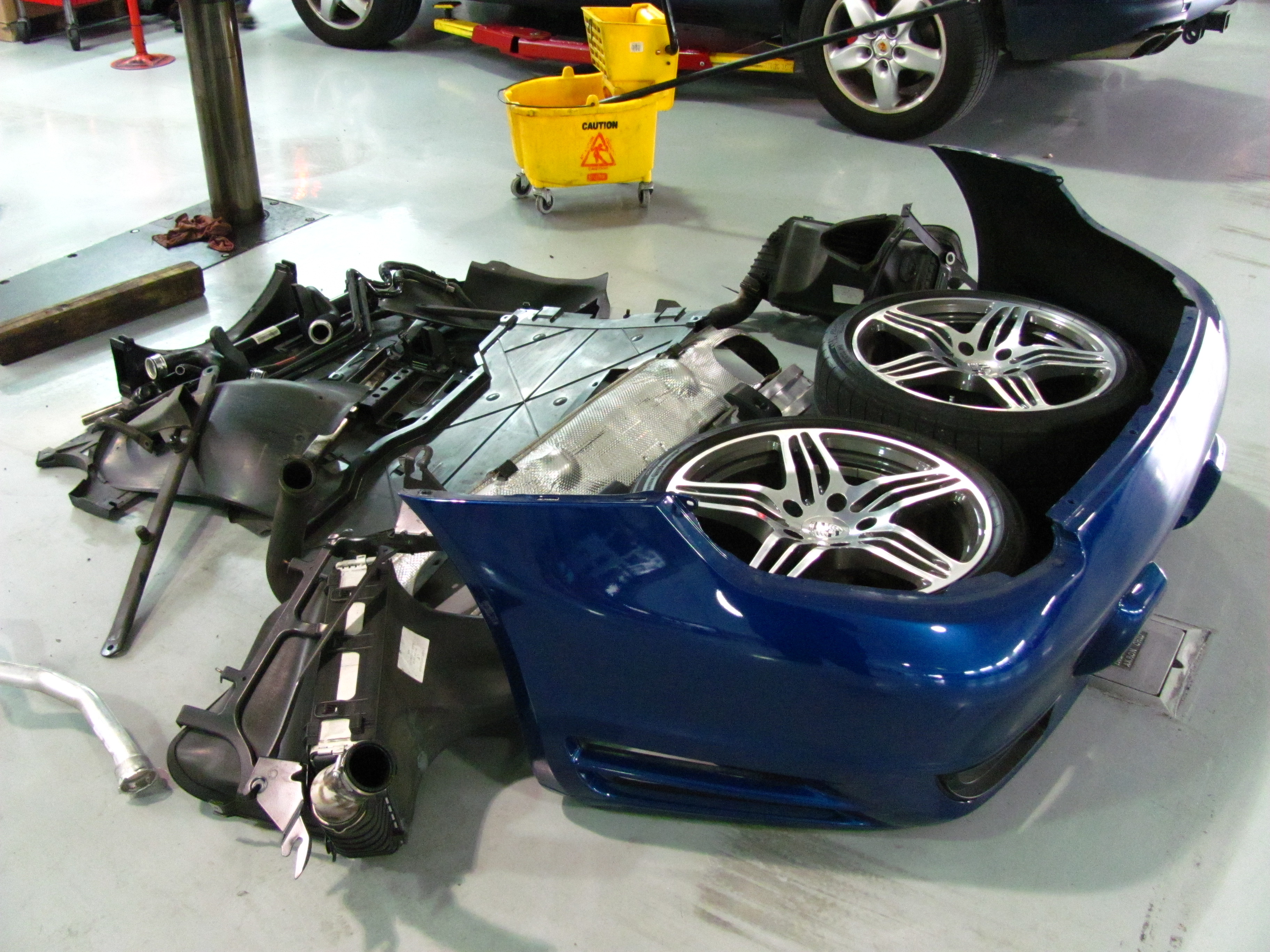

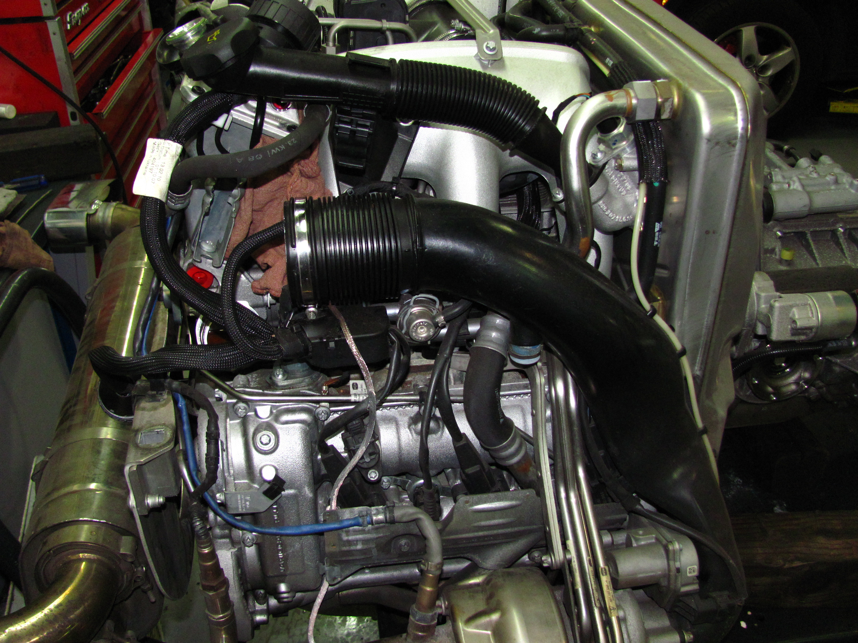

As the work proceeded i as for picture to show me the progress and thought it would be nice to share here.
So 2 weeks, 17 photos and $3030 later my car is home and all is well.
