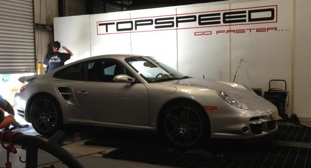

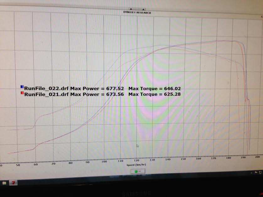

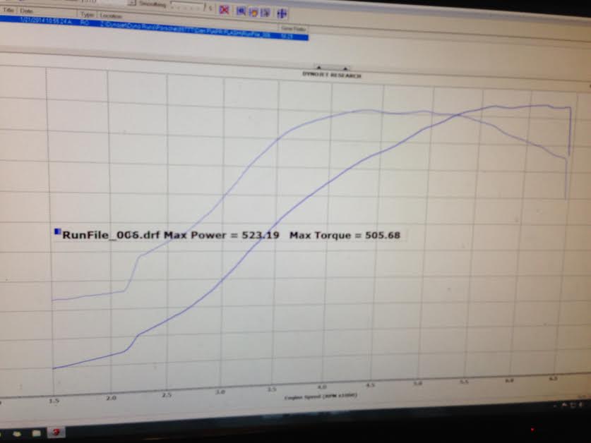

We started out dynoing the APR flash and Kline exhaust to get a baseline. It made an impressive 523whp and 505wtq. Then TSM went to work adding a Sach's 2.5 Clutch, OEM flywheel, 1150cc injectors, 5 bar FPR, and Proto 63.5 VTG turbos. The real secret weapon though is Doug, the tuner at Topspeed Motorsports. His vast experience with the Bosch ECU in Lambo's, R8's, and 997 GT3RS's that he's tuned made him very comfortable taking on the task of my E85 setup. Doug was able to extract 677whp and 646wtq out of my stock motor car with just these very mild mods. He also extended the stock rev limiter to 7250 from 6750rpm which gave me an even longer powerband. I have yet to get an all out 60-130 run, but just my second attempt yielded a 6.01 on a 1.7% slope. I believe in simple setups to maintain reliability and durability. This is exactly what this car is all about. Here are some photos and videos:
APR Flash Dyno:
E85 63.5 VTG Dyno:
