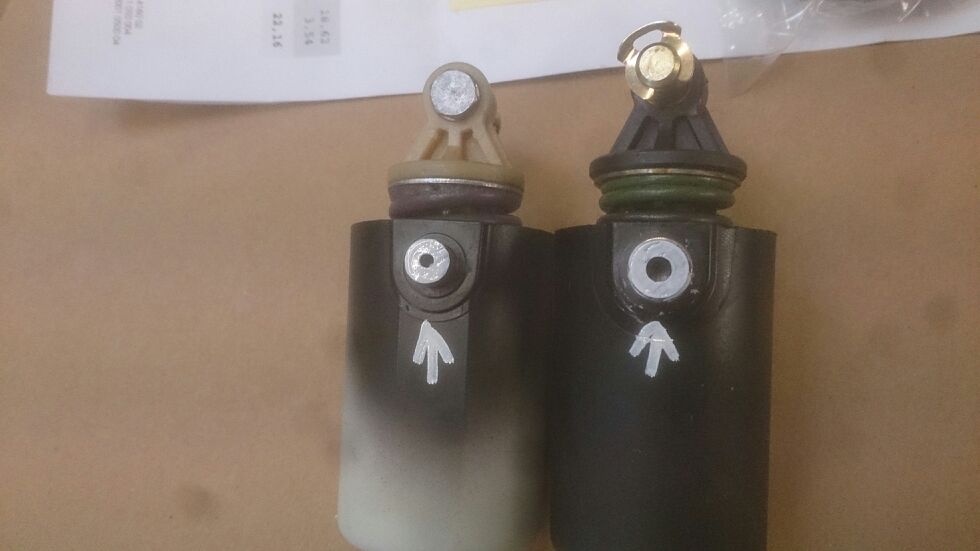

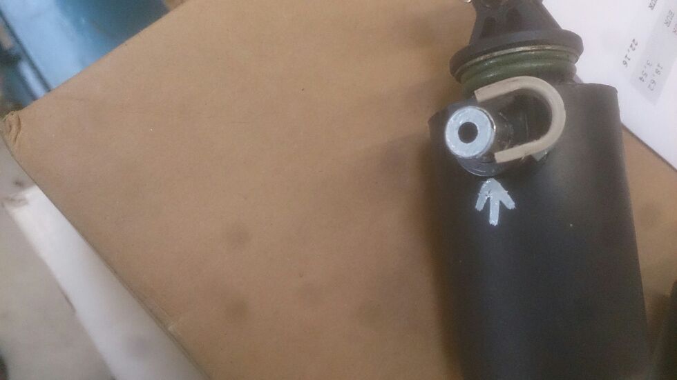

i have a 2007 997 Turbo and bought the Evoms GT2 clutch Kit last year.
Now during the installation i have a problem.
I am a little confused about the clutch assist spring coming with the kit.
Did I have to use the spring in my 997TT or not?
- The one coming with the evoms kit doesn't fit the mounting point, why?
Thanks a lot for your support guys.
Regards

Old Mar 3, 2014 | 01:03 PM
Evolution MotorSports's Avatar
Joined: Aug 2003
Posts: 2,280
From: AZ
Rep Power: 526
Evolution MotorSports Is a GOD !Evolution MotorSports Is a GOD !Evolution MotorSports Is a GOD !Evolution MotorSports Is a GOD !Evolution MotorSports Is a GOD !Evolution MotorSports Is a GOD !Evolution MotorSports Is a GOD !Evolution MotorSports Is a GOD !Evolution MotorSports Is a GOD !Evolution MotorSports Is a GOD !Evolution MotorSports Is a GOD !
Use the one supplied with the kit. The pins are slightly smaller on the new assist spring, but once everything is installed and the system pressurized, the assist spring will hold itself in place without moving.

Old Mar 3, 2014 | 01:09 PM
Stroker's Avatar
Joined: Dec 2012
Posts: 132
From: Germany
Stroker is infamous around these parts
Okay thanks, thats what i want to know.
I think i will fabricate an adapter from aluminum to get the diameter from the old part.
Thanks
