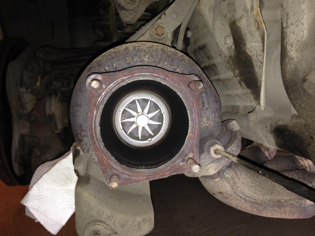

Well its just a thin clear oil film, exhaust side of the turbo looked just fine but maybe compressor side is worse. Will check it soon, need to put stock exhaust back on.

Any "oil" in your exhaust turbine area would be in the form of smoke. The high heat in the exhaust won't allow any oil films.
On the compression side, the air enters the chamber straight from the air box--relatively cool. It heats under compression, which is why the ICs exist. The spindle on which the exhaust turbine and compressor blade spin has a seal to keep oil from leaking into the compression chamber. At 100,000 rpm, I wouldn't be surprised if a little oil makes it into the compressed airstream. But, any excess might signal an out of balance spindle, or a bad seal.
Good luck,
LP
