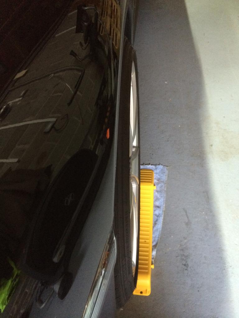

The wheels on the GT3RS and GT2RS are the same. The GT3 (not RS) has same except the front are 8 1/2". On the RS the fronts are 9 inch.
Wheels are pretty flush at the rear. Fronts stick out a little as I don't have the winglets to cover them.
There is no clearance issue on the rear at all. Same body on both cars. Only the fronts, however I've had my wheels on for nearly a year with no issues. I'm going to fit the GT2RS fenders with extenders just to make it look right. You could easily get away without (unless your car is really low). Mine has been lowered but only by 0.75 inch.
Here is a photo looking directly down from over the front fenders. You can see the tyre sticking out.
