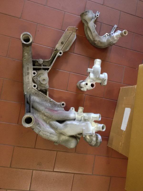

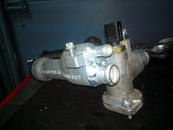

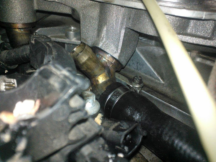

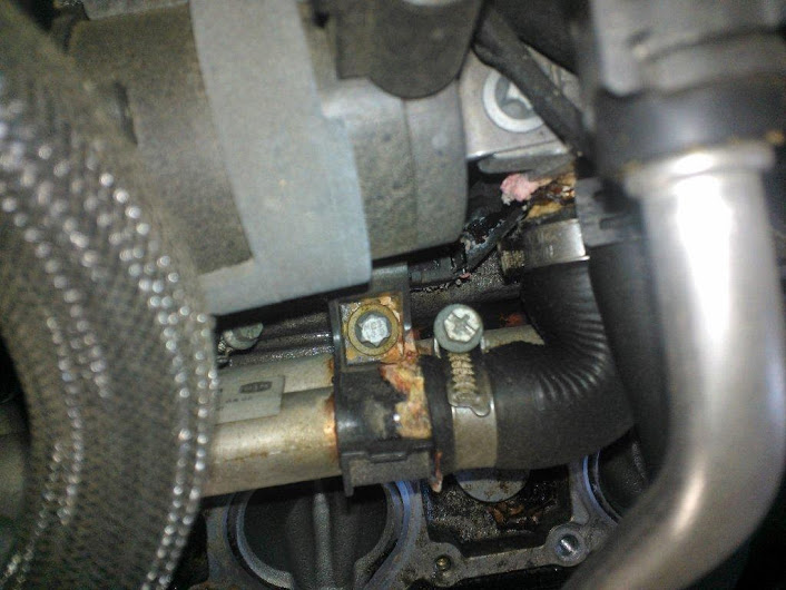

Originally Posted by GTRNICK
If its the same problem i had then it will be one of the plastic coolant pipes below the intake manifolds has split.
http://sharkwerks.com/products.php?pid=394
do these need to be welded or just clamped?
These parts are clamped.
The ones below are welded.

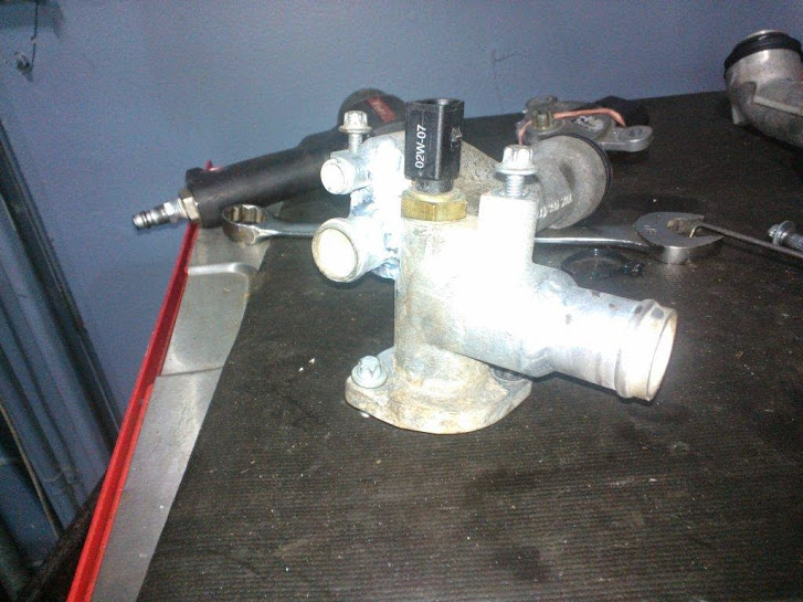

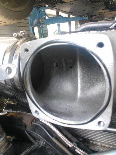

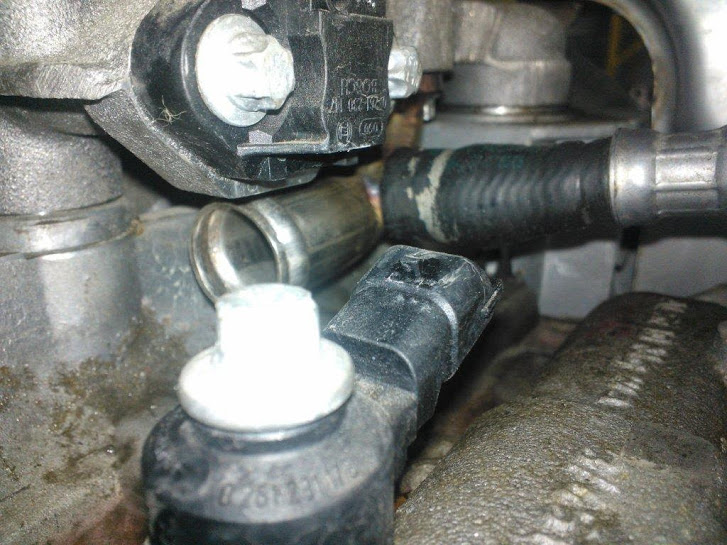

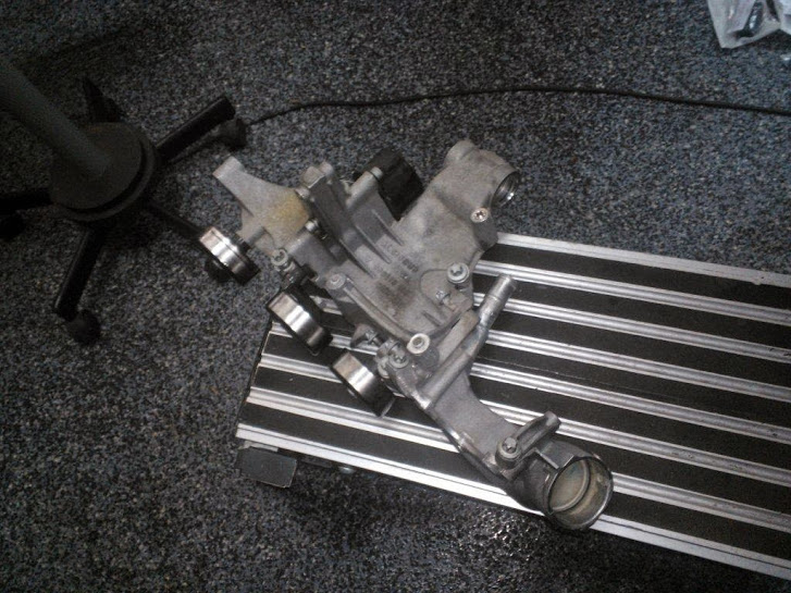

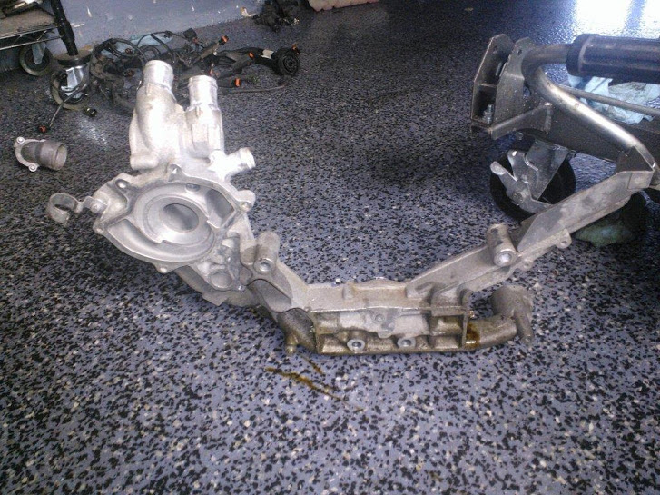

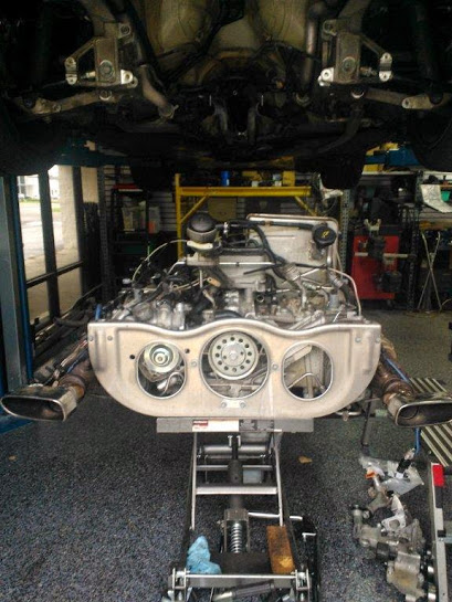

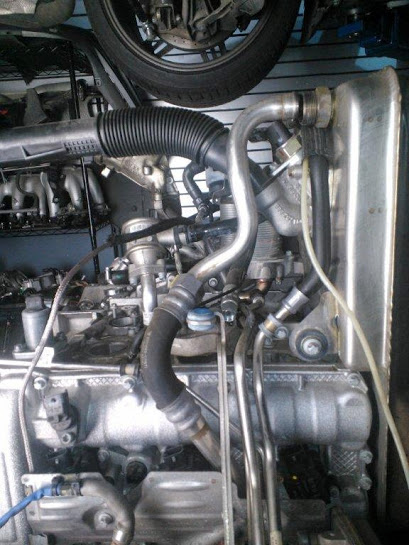

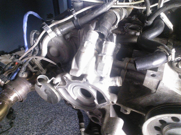

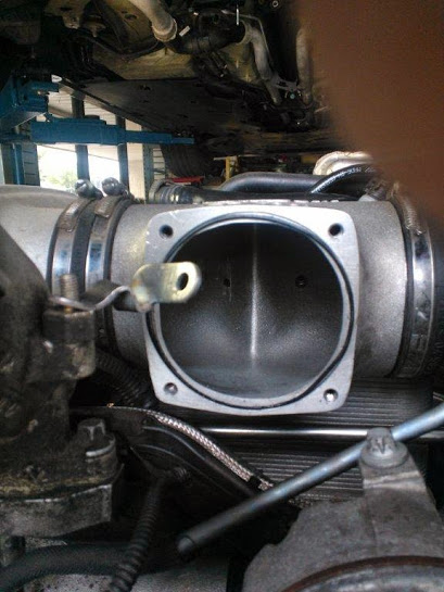

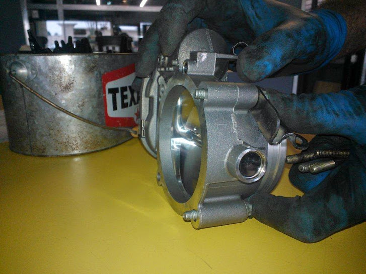

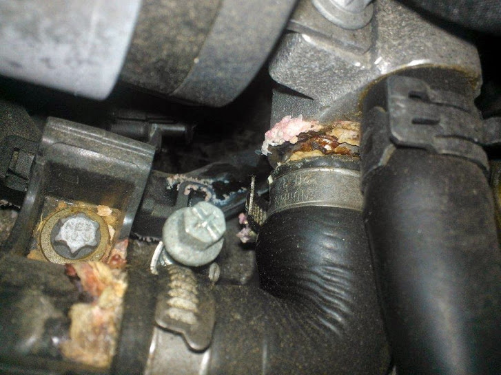

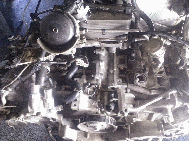

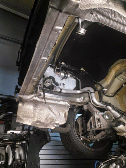

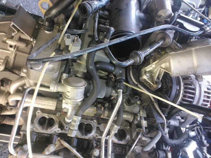

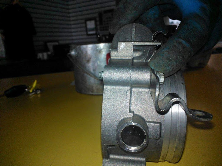

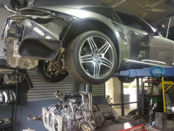

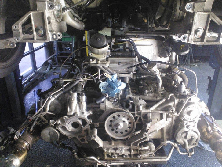

Those of you wondering if or when your coolant hose connections might fail, here are some pics of the repair on my car. There's also a few pics of the IPD Plenum install along with gt3 TB.
