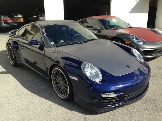

Here is my setup:
20x9 +50
20x12.5 +41
H&R Springs

Fronts are aggressive rear not aggressive enough
should I use spacers to even the rears out?
Originally Posted by aa909
yup, those fronts are going to stick way out. et45 on stock sized front wheels is pretty flush, so et40 and you're 5mm outside the fender wall
even though ill be dropped on gmg springs?
Originally Posted by DOOBEE
I run these wheel and tire specs and use a 5mm spacer in the rear, lowered on KW Clubsport. The fronts do not hang out, but if you aren't low enough they might look that way. They do tuck.
hmm... do you think ill be good after bring lowered on GMG springs?? its about an inch drop...

Should be fine on springs.

If you're getting custom wheels why resort to spacers. Build them to the desired spec. However in my opinion a 40 up front and a 50 rear would require a 5-7mm spacer in the rear. Again drop, camber setting all come into account.

thanks! if I go with these wheels ill most likely be using 5mm spacers so itll be =45 in the rear!
Unfortunately it is not custom wheels... its Advan RZ-DF, which has set offsets. a used set just popped up with the offset of +40 front and +50 rear fitted onto a 997 GT2, that's why I was asking.

^ I see if local try to get them mounted on your car first. If not go for it and figure out what size spacer you want in the rear, or you maybe be happy with the existing setup.

luckily it is local, but the only thing im worried about is that on another thread I read about how if the offset or the size of the tire is changed too much, the front diff might get effed up in the long run... is there any truth to that?

Search is your friend. The sizes you mentioned will not cause any problems
