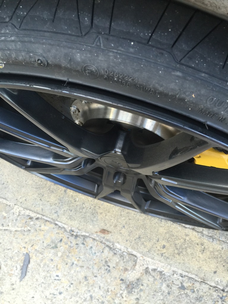

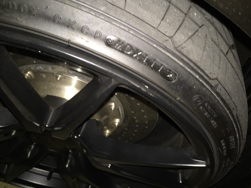

Hello All,
My 997TT came with 20" wheels shod in :-
235/30/20 FRONT and
305/25/20 REAR Invo Nittos.
Not sure of exact width of wheels, but guessing rear is 10.5. I also have stock wheels with OEM tyre sizes on them.
Even visually looking at the front on the 20's, the tires look too narrow for the wheel, and rear looks fine. Just doesn't look right to me. Pics Below both front
So I did a search, came across this thread and saw the recommendations above for 245/30/20 and 325/25/20. I can't seem to find Michelin 325/25/20 even listed as an option in Australia, but can find 245/30/20 for the front easy enough. Closest for rear is :-
-315/35R20 Pilot Super Sport
Question 1 - Will the above be good for my wheel size?
Question 2. Based on the experience here, do you think I am best to:-
Option 1
Put the stock 19' wheels back on and leave everything OEM
Option 2
Keep my 20' wheels with 245/30/20 and 315/35R20 rear
Option 3
Keep my 20' Wheels 245/30/20 front and somehow source 325/25/20 rears from somewhere
Option 4
Keep my 20' wheels on current 235/30/20 FRONT and 305/25/20 REAR
Option 5
Any other suggestions?
Would like to try and keep 20, but if the absence of a 325/25/20 rear will prohibit this, I will likely change back to 19' stock wheels with OEM tyre sizes
Any advice much appreciated
Thank you
JKay
Old Aug 25, 2016 | 09:50 AM
moacur's Avatar
Joined: Aug 2008
Posts: 278
From: Minnesota
Rep Power: 67
moacur has a reputation beyond reputemoacur has a reputation beyond reputemoacur has a reputation beyond reputemoacur has a reputation beyond reputemoacur has a reputation beyond reputemoacur has a reputation beyond reputemoacur has a reputation beyond reputemoacur has a reputation beyond reputemoacur has a reputation beyond reputemoacur has a reputation beyond reputemoacur has a reputation beyond repute
Just source 245/30/20 nitro invos to go with you 305/25/20 rears. They are a perfect match for rolling diameter. Your fronts are probably 9" and your rears are more then likely 11".
