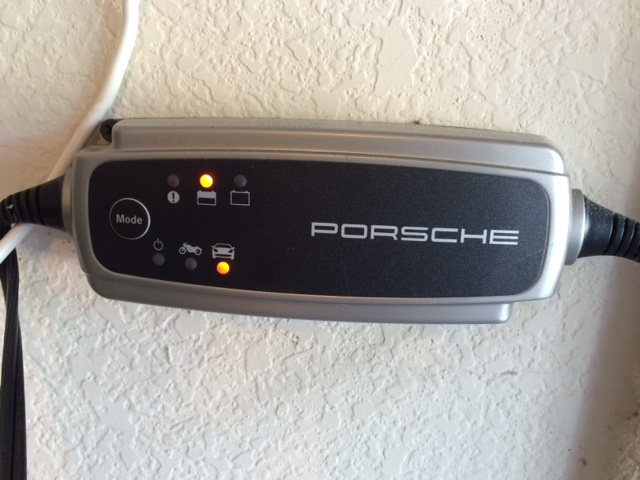

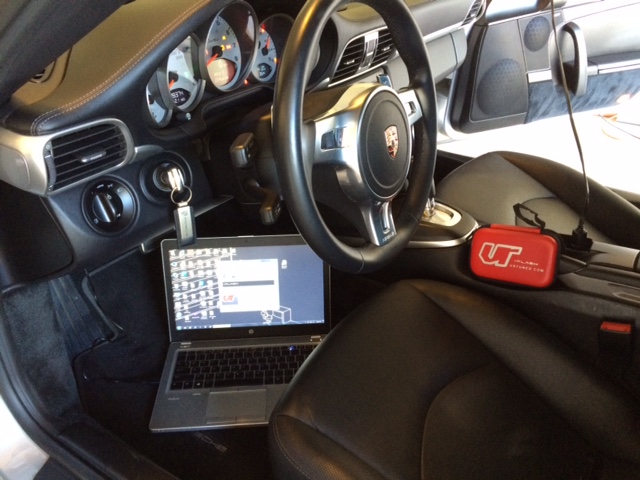

For me the steps to install where:
  • Download the VR software to my laptop (Dan actually logged in my machine and did it for me).
  • Turn the car to the on position (Plugged in a the trickle charger)
  • Plug in the USB and ODB to connect the computer to the car
  • Download the current ECU file from the car
  • Emailed the file to VR
  • Waited maybe 15 minutes
  • Received the tuned file from Dan and loaded to the car
  • Once it was loaded (since I have a DFI car) I (Dan actually logged on my machine and did this step too) logged in and ran the integrated diagnostic tool and reset a few codes
  • After that, test drive (on private road of course)
All in, I'm very impressed with overall feel of the car. Much more responsive in every mode. When you floor it in sport plus, it feels like Tyson punched you in the chest.
