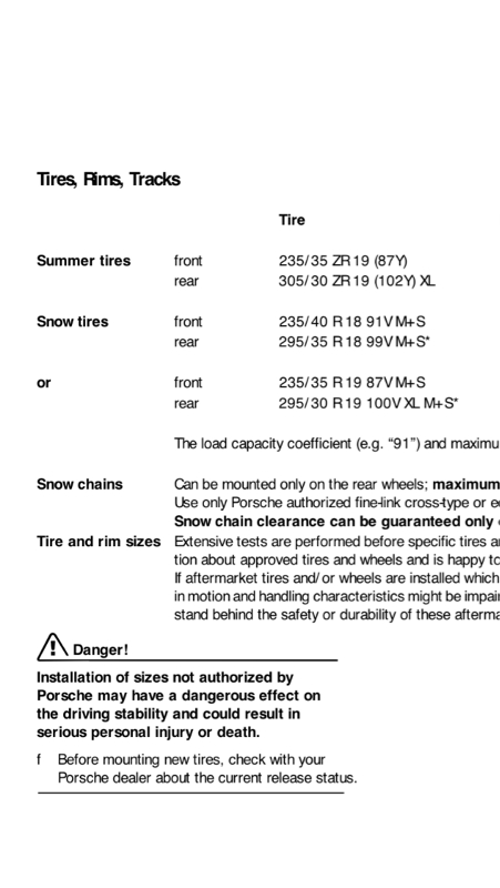

Agreed! Although I can't scientifically explain why, sounds like you are asking for all sorts of problems including handling. Stick to recommended.
