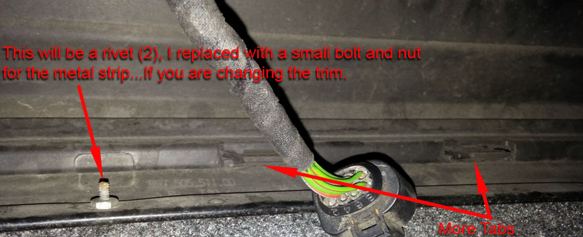

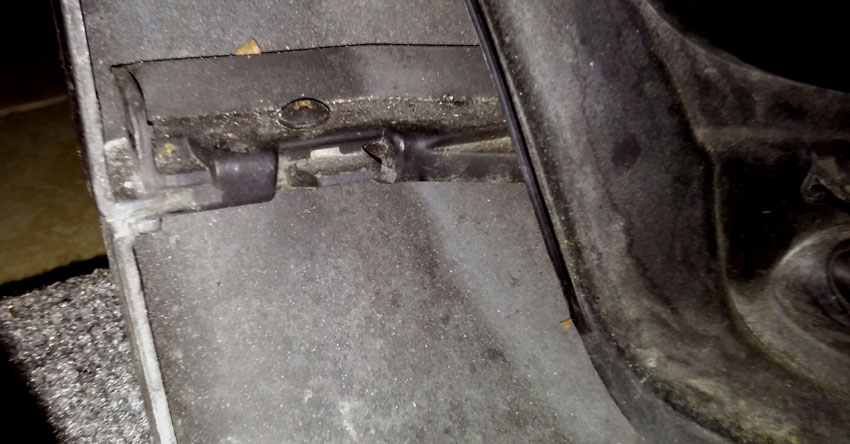

Here are some photos for you. There appear to also be screws at the end points as well as the ones that hold the bottom of bumper to the car. It may be necessary to pop the bumper cover off...but you may get lucky? I would just take off the cover to be safe and less frustrating...
Good luck...
DC

DC - thanks for the pics and info - really appreciate that!
I looked from underneath and saw a few of the hex bolts, looked similar to the sides and front, but just was hesitant to hop into it without asking first.
I am a bit reluctant to remove the rear bumper as I have the passport sensor installed on the rear (from previous owner) and worry about removing the bumper and messing that up. I will likely try to remove the lip sometime this week and if not successful, I'll just take off the whole bumper i guess.

After asking around I got the advice that you simply unscrew the bolts from underneath and you "yank" the thing out like you do with the front lip spoiler... Well I tried to do that (in my garage with car simply parked there) and it was not possible... I even jacked the thing up and after a couple of hours trying to do it with the bumper on, I decided to pull the bumper out (15 mins and have never done it before) and voila!!! In 2 mins lip was off!
If there is anyway around that (with car not on a lift) I did not find it!

Well after looking at it and attempting with the bumper on to no avail, i removed the bumper and the lip came off very easily. I would recommend only attempting with the bumper off for anyone tackling this.
this link is helpful when removing the rear bumper
