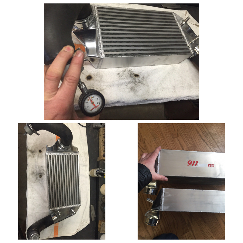

Just made a couple sets for clients and wanted to share what I do. Every core is tested to at least 30 psi and sprayed with soap and water. Notice the oem boost hoses connected as well. This way I know it's holding. Be aware that not all AM coolers will fit your hoses ( AM hoses as well). All this should be done to any AM core be it during final production or before its fitted on car. I've seen many nightmares with mismatched hoses and cores not to mention fitment issues. Check your coolers guys Markski

Good advice and info!
Here is a DIY I produced to make a quick IC tester and I used it before putting my upgrades on....Agree with you .... Definitely worth the time and effort!
Link Here
Thanks
DC

I bet half of the guys would be surprised what they find if they do it...
