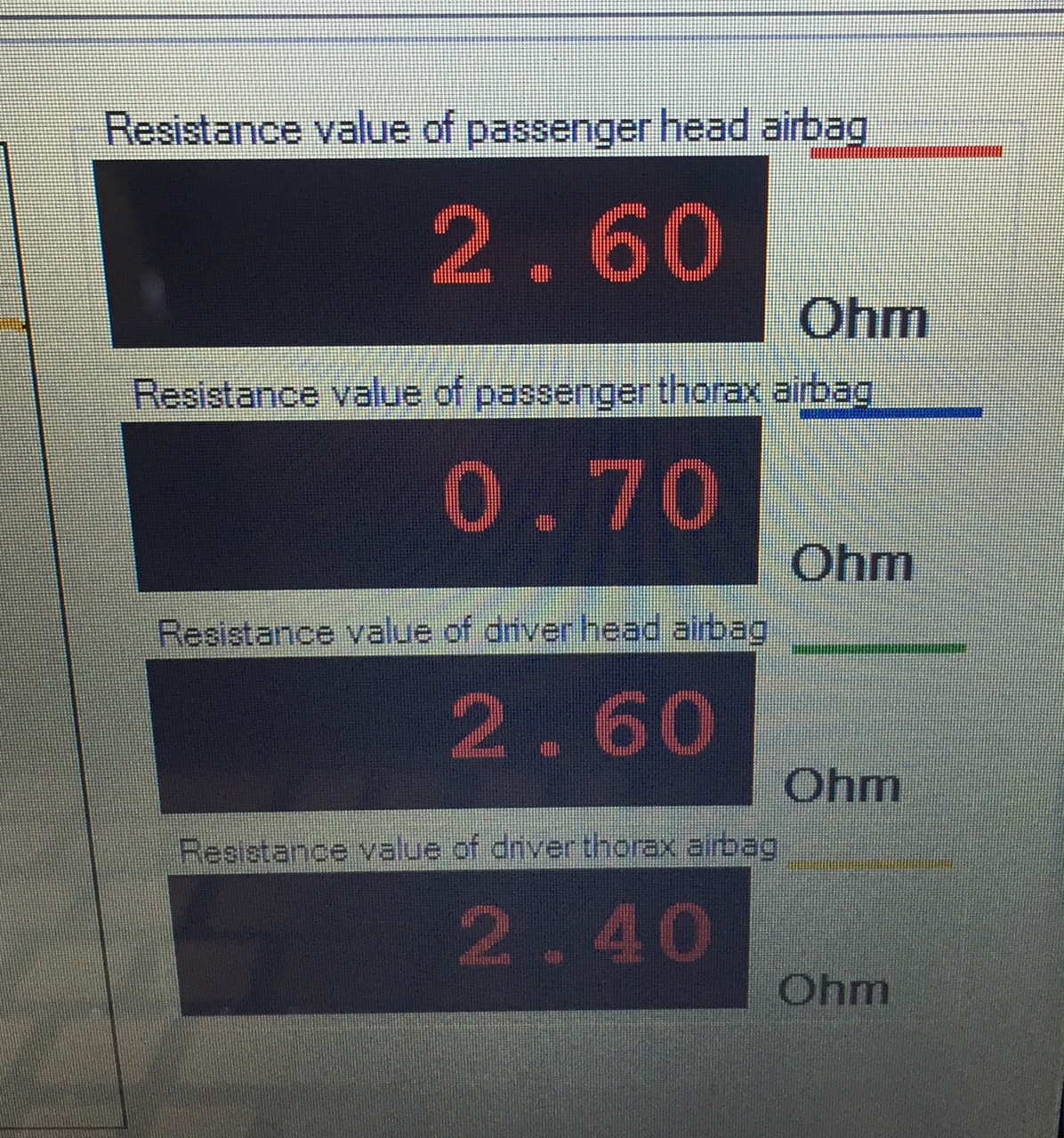

Hello all, first post but hopefully a spreading obsession with Porsche cars.
Bought a 997TT and first mod had to be GT2 seats which I had read was a simple plug and play. Found some great seats online with all brackets and needed hardware and in they go.
Then starts the fun! For some reason, even with battery disconnected, the airbag light came on the first crank after the seats. I figured just a connection but after hooking up my Durametric, it appears one airbag is faulty showing lesser ohms resistance. Anyone have a clue how to go from here or how to even code it out in the Durametric software? Thanks in advance!

Originally Posted by cbst09
someone else just had the same problem, I think he went to the dealer to have the light reset. You may want to check with ryun. good luck
http://rennlist.com/forums/997-forum...bag-light.html
Mine actually says nothing about the "Passenger Airbag Off" in the console, but the red airbag light is on the dash. With my Durametric pro, I can see that it is due to the the Passenger Thorax Airbag values are incorrect. I am guessing this is the airbag in the door panel side of the seat which all wires are lookin correct and nothing pinched. Previous owner of seats verified no issues with pulling them out of his car.
Any other thoughts other than a bad airbag? It has little/no resistance like the others...
