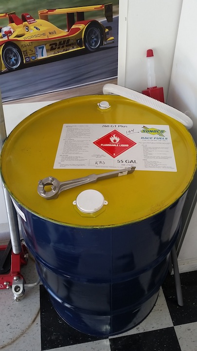

Thank you KRS Distributing. Five minutes ago my octane problem was solved.
I'm surprised more of you don't do this. 3gl of 104 octane to 12gl of 91 equals 93.6 octane. At the current Chevron 91 price, it works out to $5.17 per gallon for the mix. For those of you running CA crap gas, this really wakes these cars up…Especially if you have a 93 oct ECU flash.
Sunoco 260 GT Plus
Octane (R+M)/2 104
Research Octane 110
Motor Octane 98
Stoichiometric Air/Fuel Ratio 13.7
Oxygen (weight%) 4.7
Ethanol (volume%) 13
Lower Heating Value (Btu/Gallon) 110300
Lower Heating Value (Btu/Pound) 17400
Leaded No

Kevin at KRS is awesome. Race fuel delivered!
Old Apr 29, 2015 | 09:59 PM
  #30
Craig T's Avatar
Joined: Apr 2015
Posts: 5
From: Ventura County
Craig T is a jewel in the roughCraig T is a jewel in the roughCraig T is a jewel in the roughCraig T is a jewel in the rough
No kidding. I call Kevin yesterday and 24 hours later he comes to my house and drops it off. How easy is that?
