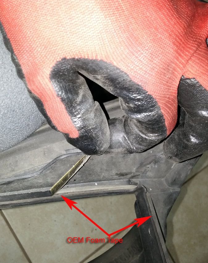

Yep..I listed the parts and prices for just the plastic shroud pieces needed on another thread....Here they are again:
5 - Part Number: 99757565701
intake duct 3.8 LITER Left
MSRP: $301.55
5 - Part Number: 99757565801
intake duct 3.8 LITER Right
MSRP: $301.55
6 - Part Number: 99757586901
intake duct gasket 3.8 LITER Left
MSRP: $34.98 $0.00 $25.58
intake duct gasket 3.8 LITER Right
MSRP: $34.98
9 - Part Number: 9975754710101C
lower duct 3.8 LITER Left
MSRP: $291.41
9 - Part Number: 9975754720101C
lower duct 3.8 LITER Right
MSRP: $291.41
10 - Part Number: 99757589000
lower duct gasket 3.8 LITER Left
MSRP: $34.98
10 -Part Number: 99757589000
lower duct gasket 3.8 LITER Right
MSRP: $34.98
You can find these cheaper, or used, but at MSRP you are looking at : $ 1328.84 + Shipping and/or tax.
If you want to add the hoses also, here is that info:
COOLING SYSTEM / COOLING / INTERCOOLER / Pressure hose
Part Number: 99711064470
pressure hose 3.8 LITER, upper Right
MSRP Core $90.20
Part Number: 99711064570
pressure hose 3.8 LITER, upper Left
MSRP $90.20
Part Number: 99711063572
pressure hose 3.8 LITER, lower Left
MSRP $84.85
Part Number: 99711063672
pressure hose 3.8 LITER, lower Right
MSRP $84.85
Total Additional : $ 350.10 + Shipping / Tax
Do what makes you happy, and what you are comfortable with...I just offered an option and the way I achieved it. And BTW..When you pull apart the OEM pieces...guess what...Foam tape..uh oh
DC
