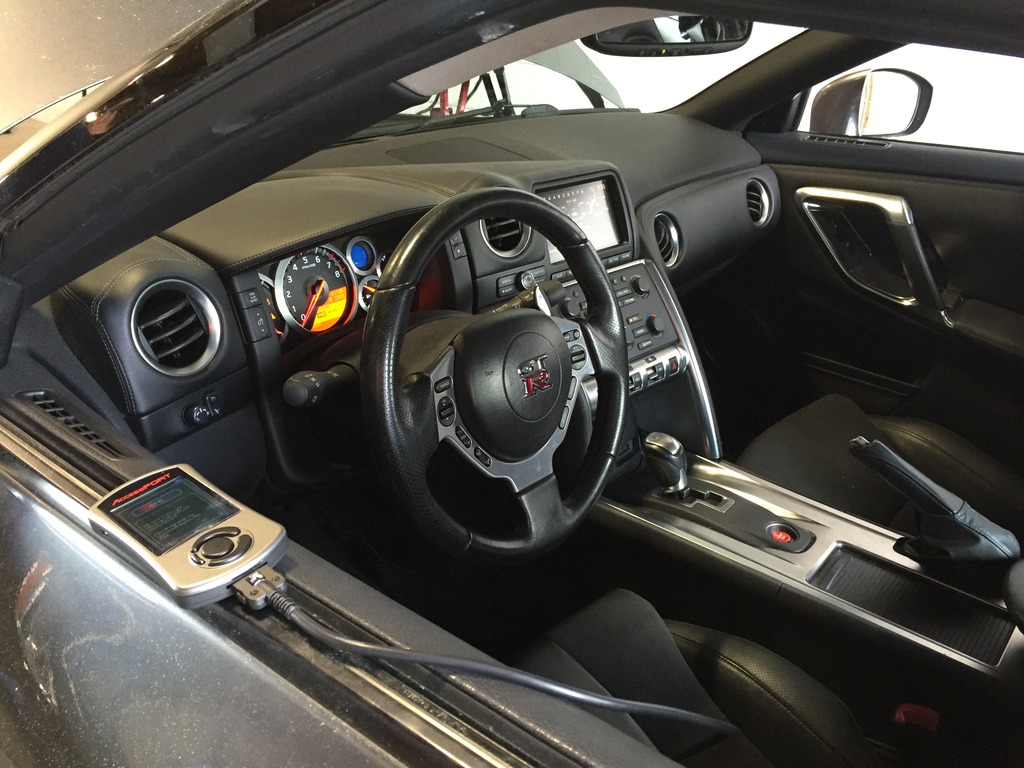

Haven't had the chance to take the Porsche out again yet, but I Cobb tuned my GTR today and the power increase is much more noticeable! Car is significantly quicker than when it was stock.
Mitch, thank you for sending me the new file for the Porsche. I will be uploading that this week, if I have any questions about it, I will shoot you an email. Do you handle GTR tuning as well, or just Porsche? If so, I got some good logs with the GTR that I'd like someone to take a quick look at who knows what they're looking at.

In my past life before Porsche I tuned a few GTRs
Shoot them over happy to take a look!!
