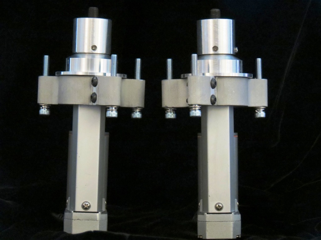

Here is the 997 turbo eRam prototype kit. Sent out this week to my friend Rob for test fitment. Fingers crossed!!

997 TT eRam Kit is READY!
Finally the 997 TT eRam kit is READY! It took a long time and there were some design challenges along the way, but with the dedicated and generous help of a forum member from Oklahoma, WE DID IT! I'm so proud of this kit. It is a true upgrade from the 996TT kit. Here is a sneak peek: http://rennkit.com/product-info/997-turbo-eram-kit-2/
Now I need some beta testers. I will offer a one time discount for owners to install the eRam kit in exchange for pictures, feedback, suggestions on improvements, etc. Let me know if you are interested.

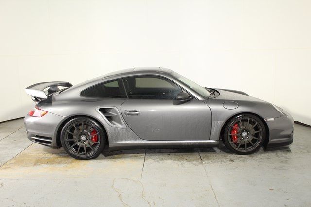

gt2 wing. Absolutely transforms the car.
