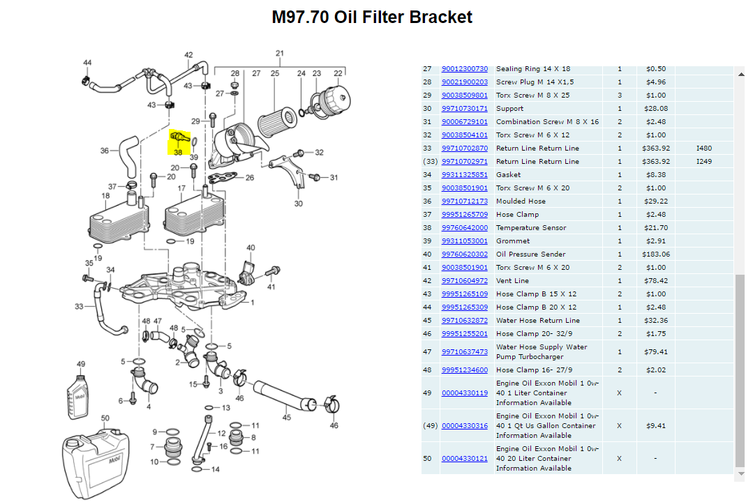

Rather than talking about Boxsters which have no relevance to your question or your car.... Here's a diagram. Highlighted part 38 is your temp sensor. Not sure what it's like to work back there.. From my understanding, the 997TT oil temperature sensor is a relatively common piece to fail and it can be intermittent- so it may work the next time you get in the car, may not.

Seattle, that sensor is a water temp one, oil temp sensor is the oil level sender, follow the oil filler neck its just behind it. Try checking for a loose connector and clearing the error code before changing it out. Happened to me once, I cleared the error with a durametric and never happened agaian

#40 is the oil pressure sensor. Mine went bad last year. Oil pressure would be fine then hit zero. Very scary at the time. I had it replaced by a indy.
