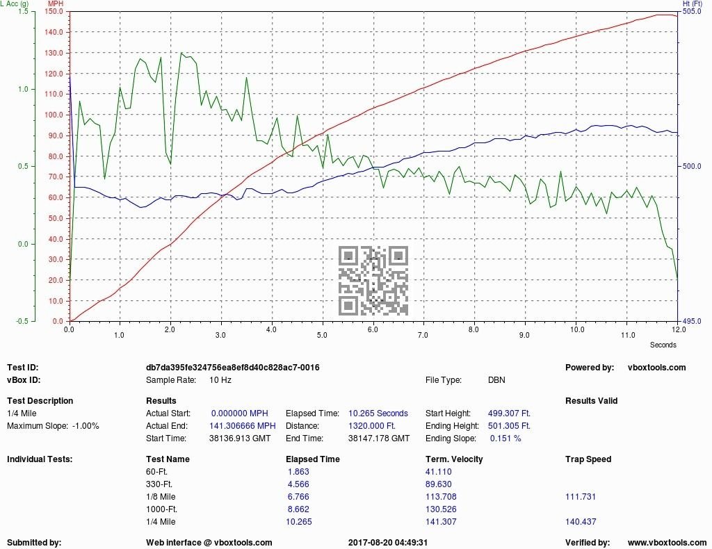

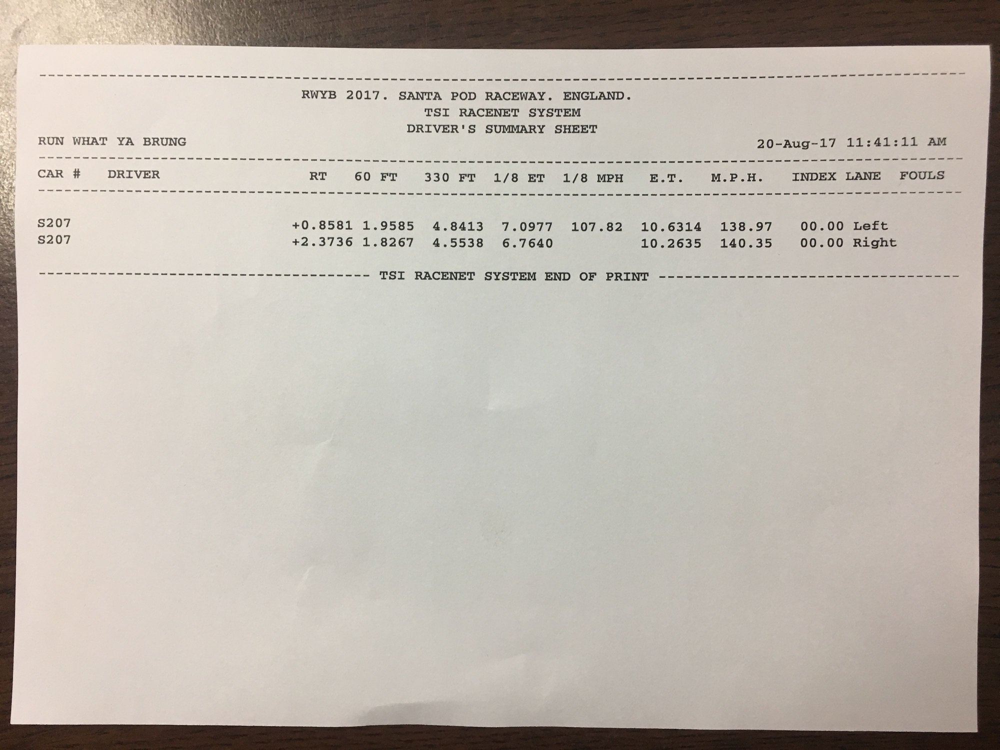

Today I went to the only official drag strip we have in the UK today (Santa Pod) with my car. It was a 'Run What You Brung' day which means the track wasn't prep's. The weather was good so it was time to get some numbers in. The outside temperature was 19.5 degree C. I was hoping it would have been quite but it turns out I couldn't have picked a more busy day ha! I drove the car up and kept it nice and cool with my intake temps sitting around 15 degree C. After 20 minutes of queuing, the car was up to 35 degree C - after I had signed on and joined the track queue, the car was over 50 degree C!!! With no space to do any driving to cool the car, I had to line up with extremely high intake temps.
The results are as follows:
10.26 at 140.35MPH with a 1.82 60FT
I only did 2 runs due to the heat and queuing. Overall I'm super happy with the results. To clarify for the record my setup is unchanged! Full BOLT ON, Michelin Pilot Super Sport OEM Size Tyres, Shell V Power Pump Fuel & Full Weight. I ran with 1/2 a tank of fuel. The track was NOT prepared as this was NOT a test and tune day.
Once again - thank you to ESMOTOR and everyone involved in making my car happen.
Im sure this car will do a 9 second pass on a drag radial but I fear my driveshafts may fail. For now - I'm a very happy customer

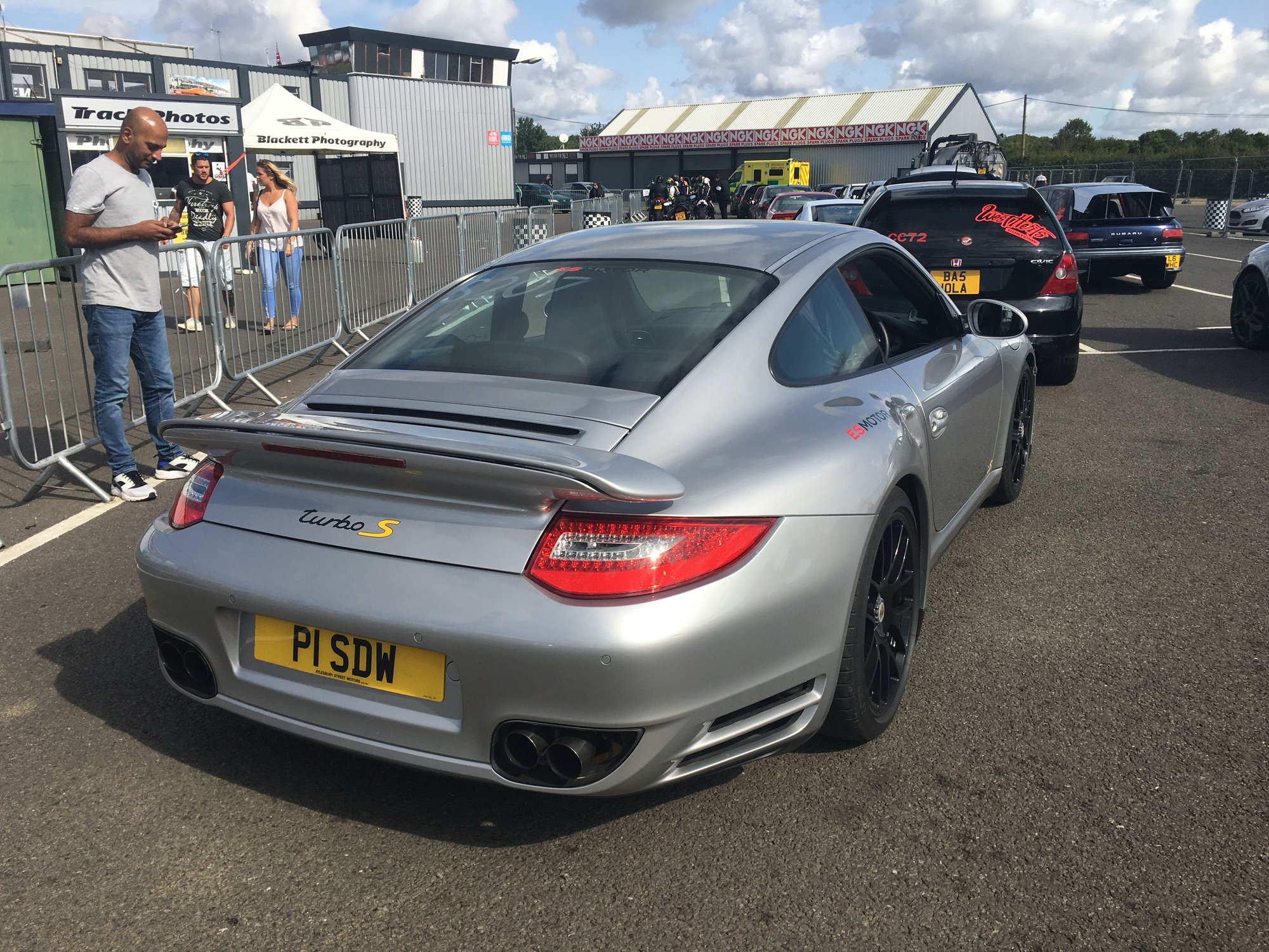

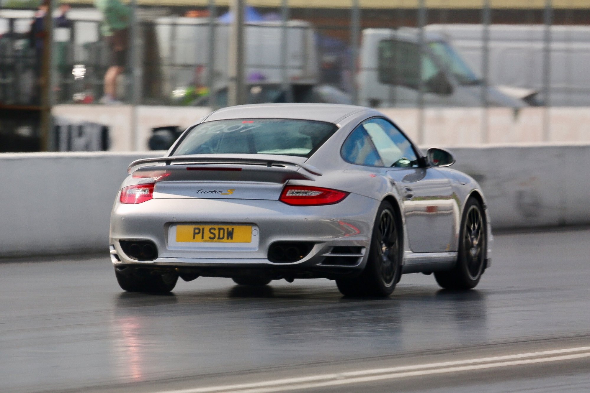

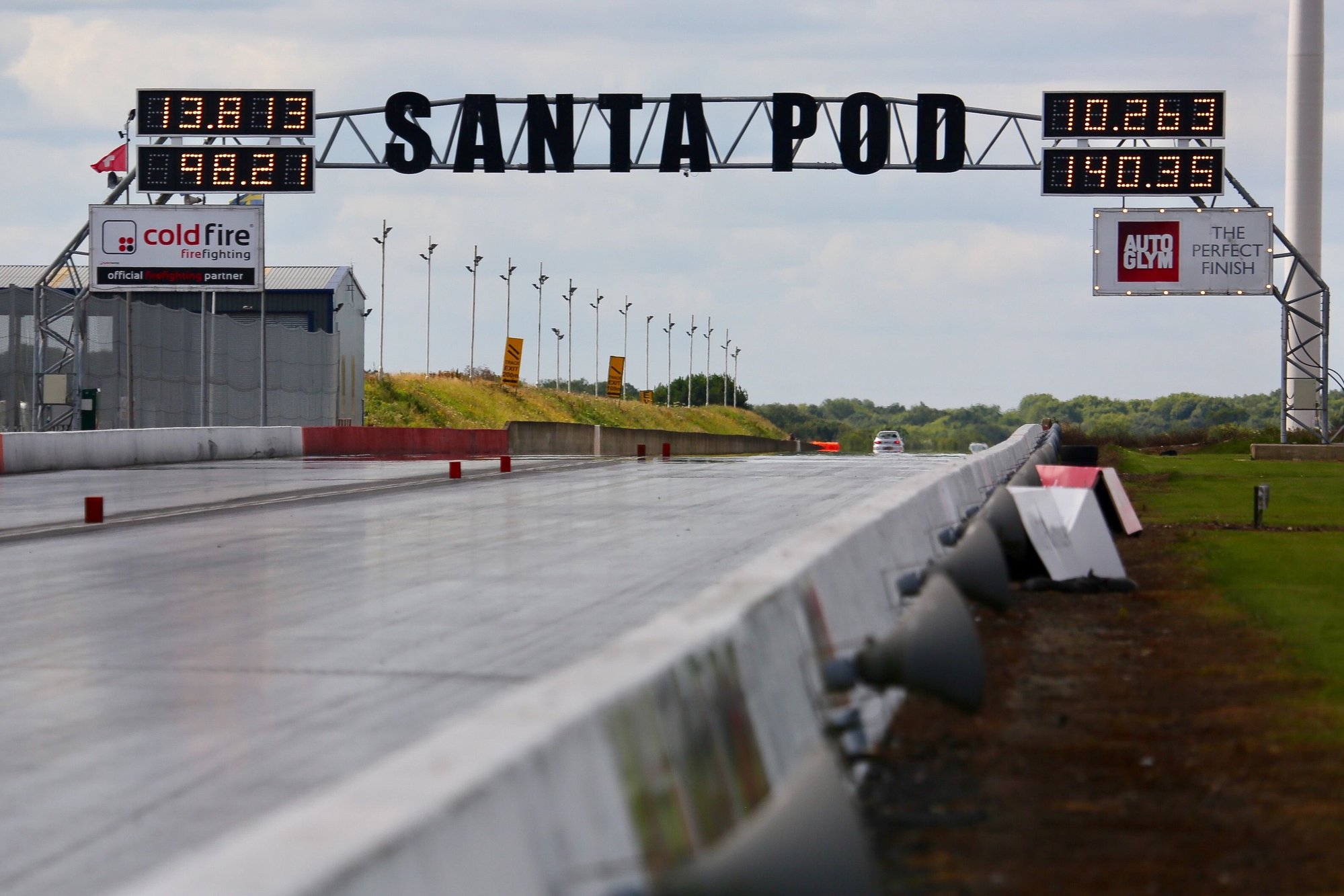

Some photos from this weekends drag racing.
