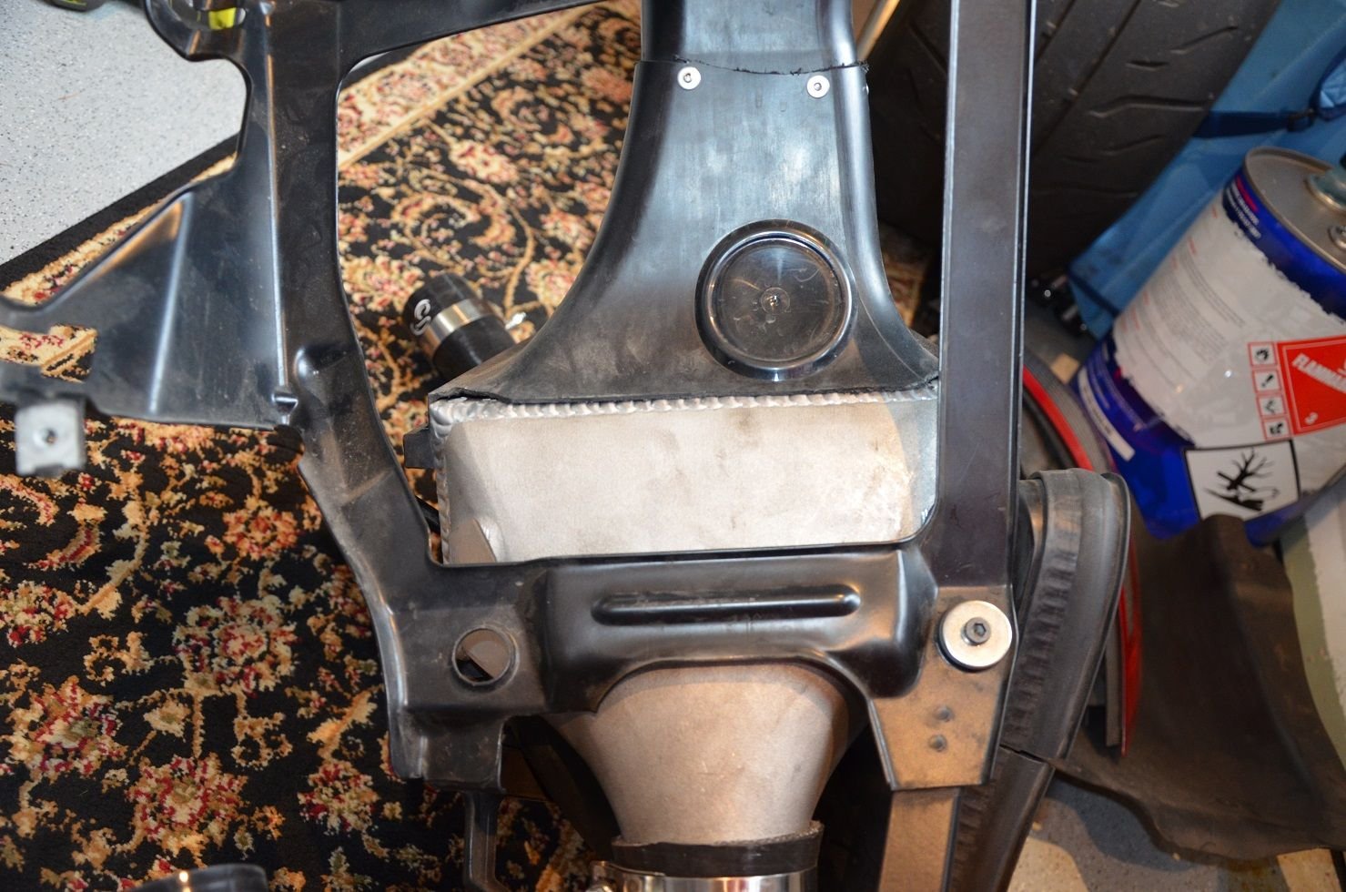

Yes they are 2 piece. It's just the rear vertical section you need to remove.
Three torx screws a long the top,.. and 2 more near the bottom.
I just pulled mine off today to swap turbos, and I measured the port for you.
(Recent ByDesignAuto IC's)
The hole is 2.2" diameter. So unless someone forced a tennis ball down your fender,.. there shouldn't be anything in there that you can't easily remove.
Here are a couple pics of the driver's side from the front.
