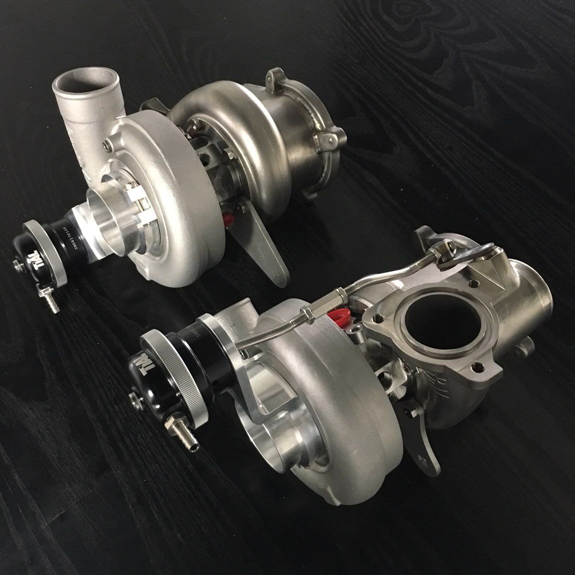

Some turbo ****:

Here's the bad boy getting installed. I had no idea where the wastegate emptied, lol, but if you look at the end that connects to the exhaust you see that there is a concentric exhaust path which is used when the wastegate is open. Pretty cool.
The astute amongst you will notice something missing...the little oil catch cans that are a necessary part of the installation. Well guess what, when the shop took off the Champion 68s and I shipped them to a 6speeder in Florida the oil cans were still on the turbos. I wasn't able to get a hold of the buyer but I doubt he'd still have the oil cans anyway. I guess I'll see a little bump in the final bill, lol.

The lines going to the Xonas are the stock car parts with the exception of the braided hose seen in the pic. That line must be made of solid gold for what it cost...or maybe fool's gold, lol. It joins the hose on the other side via a t-adaptor and this is the coolant supply to the turbos.

Here's one of the brand spankin new oil catch cans. The original turbo heat shield is on but it doesn't quite fit - it needed a little trimming and the attachment point that would normally bolt onto the oil catch can was cut off so it wouldn't rattle. Great attention to detail from my shop...

Don't try this at home! Thanks to M3Maestro for the picture he sent me which showed where the bovs could be welded. I gave it to my shop who gave it to the welder. Obviously it had to be measured specifically for placement and the welder even factored in the orientation of the welded piece so that the bov nozzle would point in the right direction!

the end result. Apparently it's supposed to be the vband version of the bov that gets welded but he did it for me anyway.
