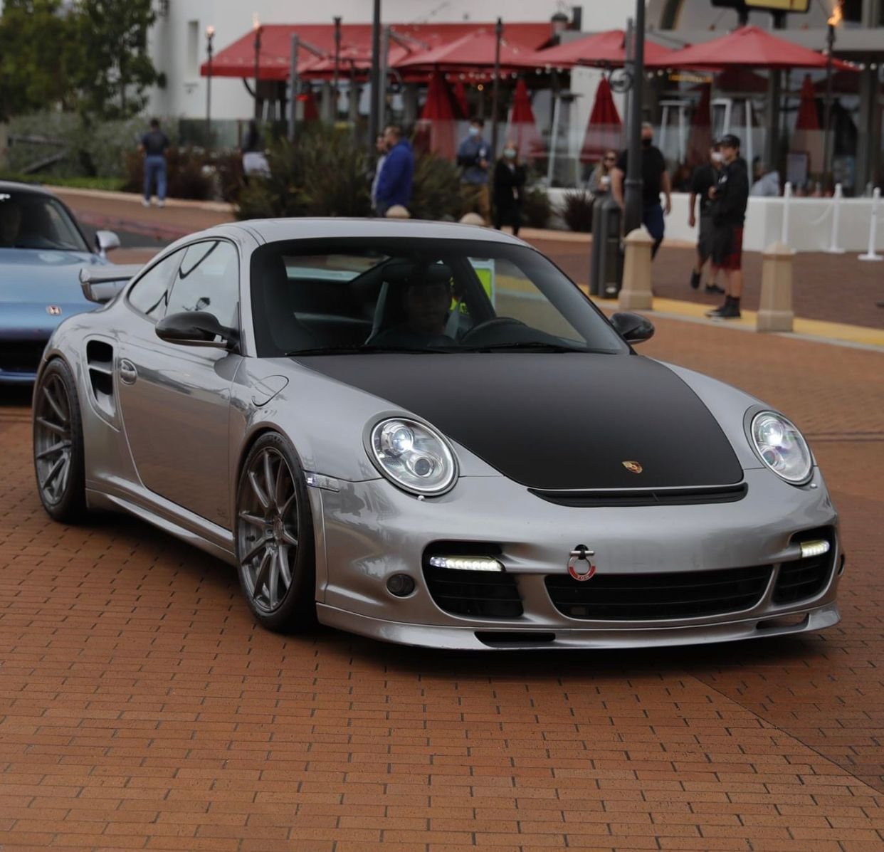

That's definitely a great look for sure but that's a long list of parts and labor which is gonna be pretty costly, a quick inexpensive way to spice up the front of your turbo bumper is ,get a Aero kit front lip ,& install a GT2 radiator vent ,throw on some Drl's & a Renline tow hook & bam your done .

Thank you guys for your messages!! I did a research on the GT2 front bumper parts and it truly is costly, even though I do like the OEM GT2 look, I feel its just to much labor and cost wise to do it (personal opinion). So I think I will go with the simple solution by adding an aftermarket GT2 vent and also changing the lower front lip. Again, thank you all for your help.
