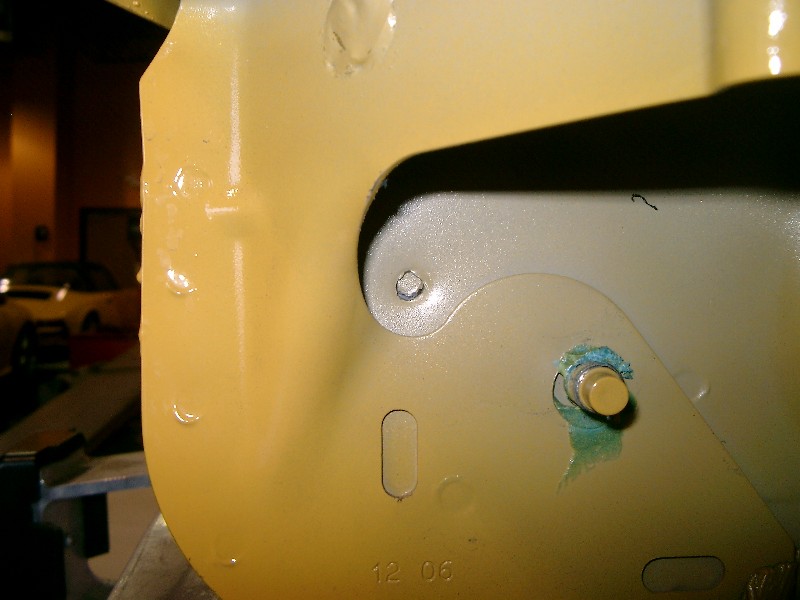

Welds? see https://www.6speedonline.com/forums/...ighlight=welds. Check your VIN...there's a list floating around out there of cars affected.
Other welds? Can you be more specific? Also, the picture from your previous thread seems to be dead, can you upload some pictures for me so I know where to look for the defect?

Behind the intercooler on farthest rear section on the inner 1/4 wall there is a series of spot welds. The welds in this area particularly the one at the farthest position pulls. The inner engine wall and the inner 1/4 wall then creak.
