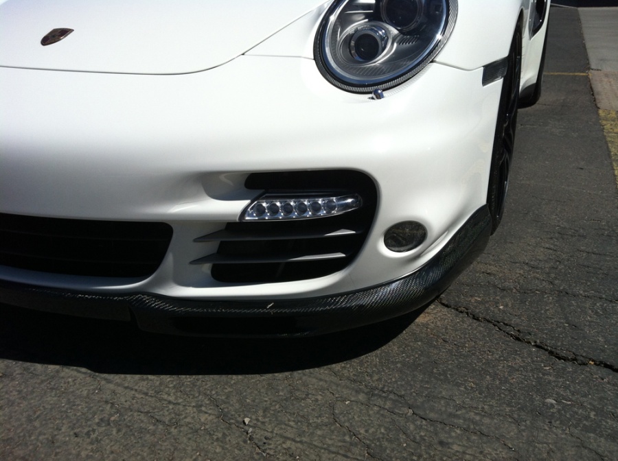

For those that installed them and are happy, we are glad and thank you for sharing the pics. For those that have experienced a defective part and not received a replacement, please confirm with me and I will take care of it if not already done.

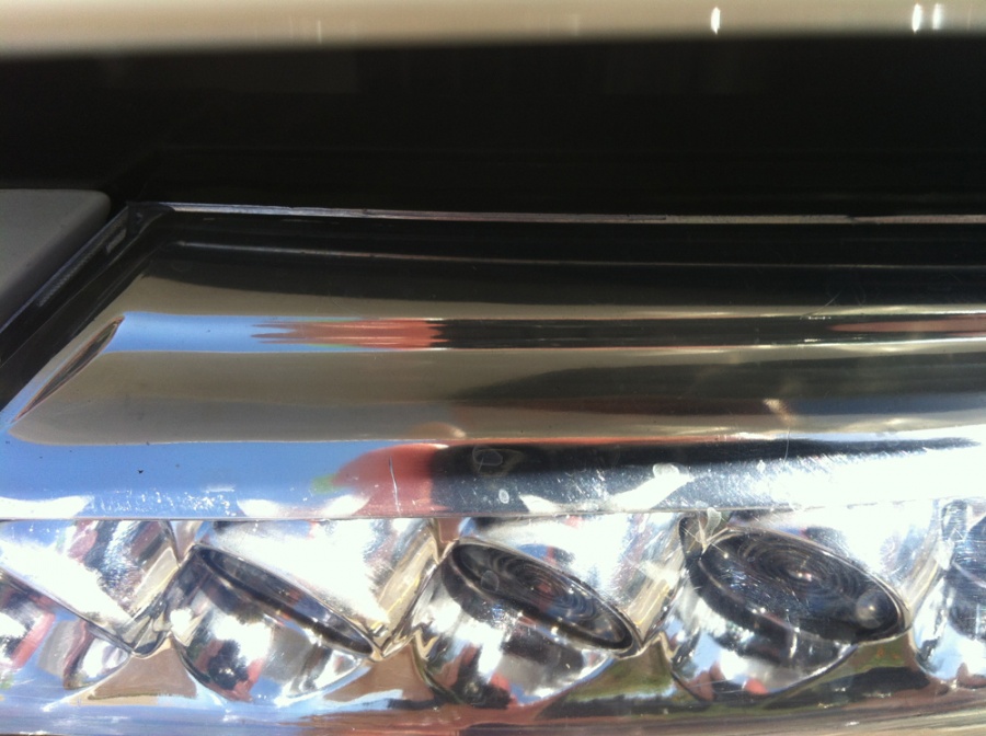

Another thing and will be brutally honest, the inside of the light on top where the chrome paint is, all have 3 small hair line scratches that are part of the assembly. If you looked or followed the thread from the beginning, you can see the molds and process these went through to be made. Yes these can be seen when you have the light in your hand. The electrical issue is something we can and will continually take care of, but for the people that have a complaint in regards to this cosmetic manufacturing piece, we will gladly refund you when the lights are returned here with an RMA. Contact me via email or PM.
This is NOT AN EXCUSE. I understand the high expectations those have and even though this is not something that affects the function or can be drastically seen we have no problem in taking them back.
Today I just went and looked at mine and at a close look, yes you can see them. Looking at my car daily, I just dont think twice as they look awesome at night!
