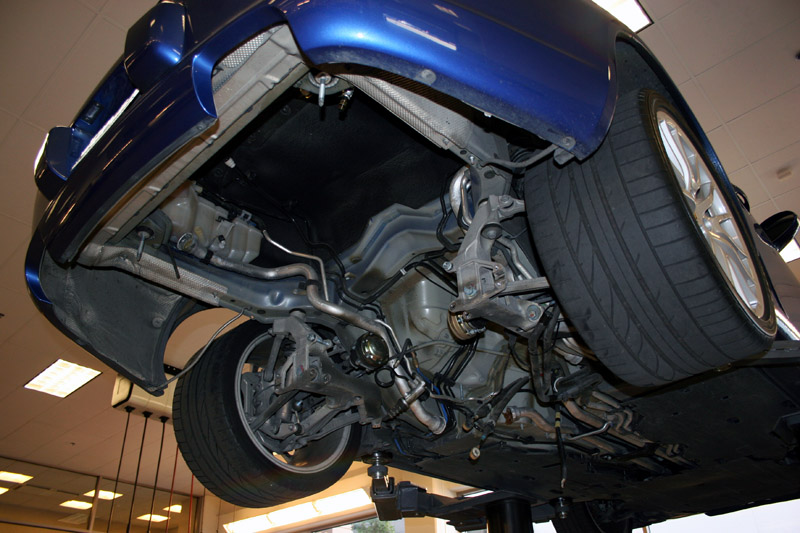

I got a call that the new engine arrived today so I went up to the dealer to scope things out. It turns out that the intermediate shaft was the cause of the failure. The tech had seen this happen before.
I have taken some pictures of the old and new engine, and on the old engine picture I put a red circle around the piece that caused the failure. They have already mated the new engine to the transmission, as well as put my old headers on the new motor.
The tech and I noticed a difference between the new and the old engine. The new engine has a different style to the piece on top of the intake manifold. This can be seen in the pictures. The new manifold is smooth at the tops where it says Porsche, and the original piece is textured/bumpy where it says Porsche. Anyone know why there would be a difference? The only thing they transfer from the original engine is the a/c compressor and belt.
Here are the pics:

Here is a picture showing the texture on the intake manifold from the old engine.

Pretty sure its just earlier design...........here's replacement engine for a 3.6 996 that went in one of my cars last year.
