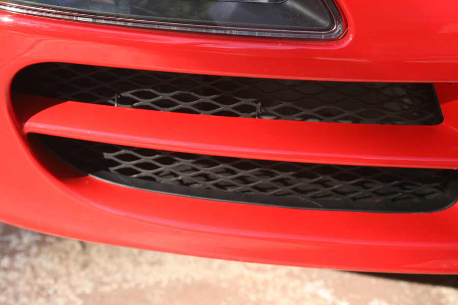

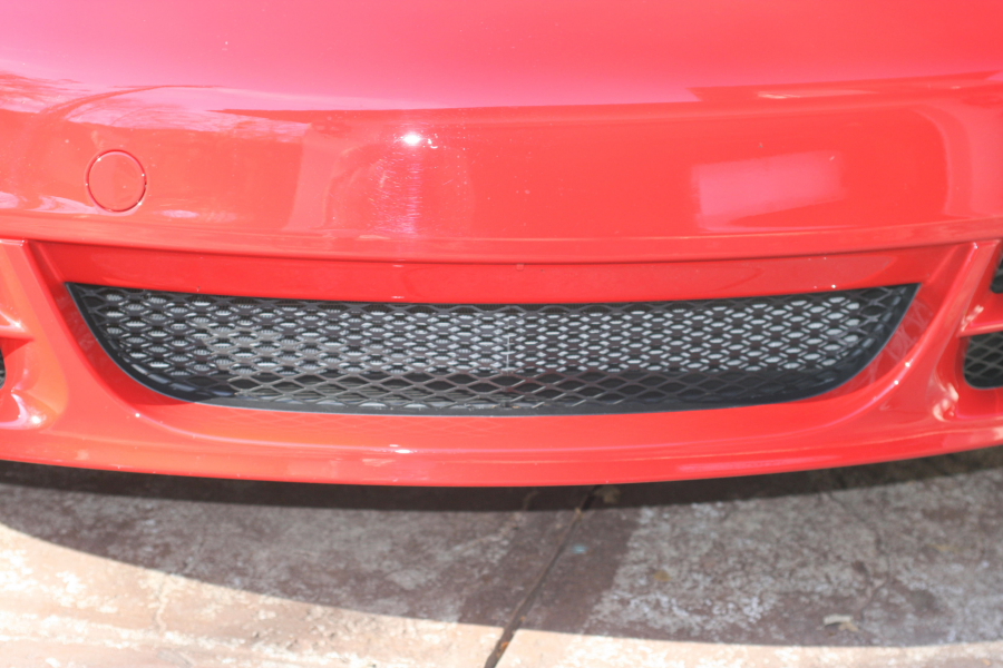

I went to the local hardward store and bought I think 18g grill like the ones that are used to hold charcoal in the bbq....diamond shaped holes. I carefully measured and used a carboard template to cut the grill using a drummer drill. Painted a few times with flat black rurstolean paint. The middle section is nice because their is already a groove you can fit the grill into by folding it a little. The side sections fit really snugg so they dont move. You can do all of this WITHOUT removing the grill if you are handy. You can use 3m for the side attachments...or what I did was used a stainless still rod about two inches long the diameter of a coat hanger. On one side I attached it to the grill and the other in a groove the seperated the middle horizontal opening...if you slip your finger you can see that there is a groove you can seperate between the painted part of the car and the air intake. I bent the s/s rod and it hooks there. I have gone 100mph without having the grill move.
Costs $30 and avoid removing the bumper.

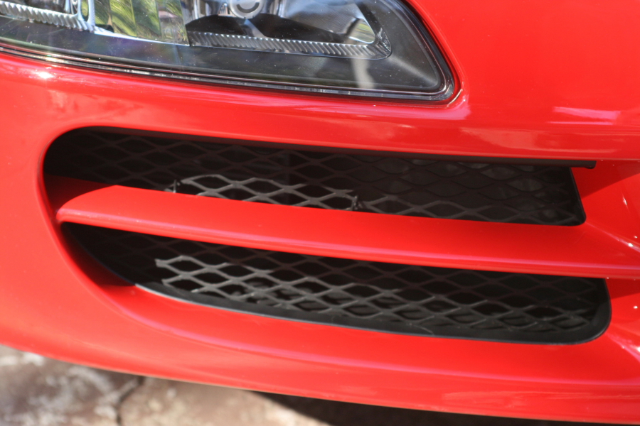

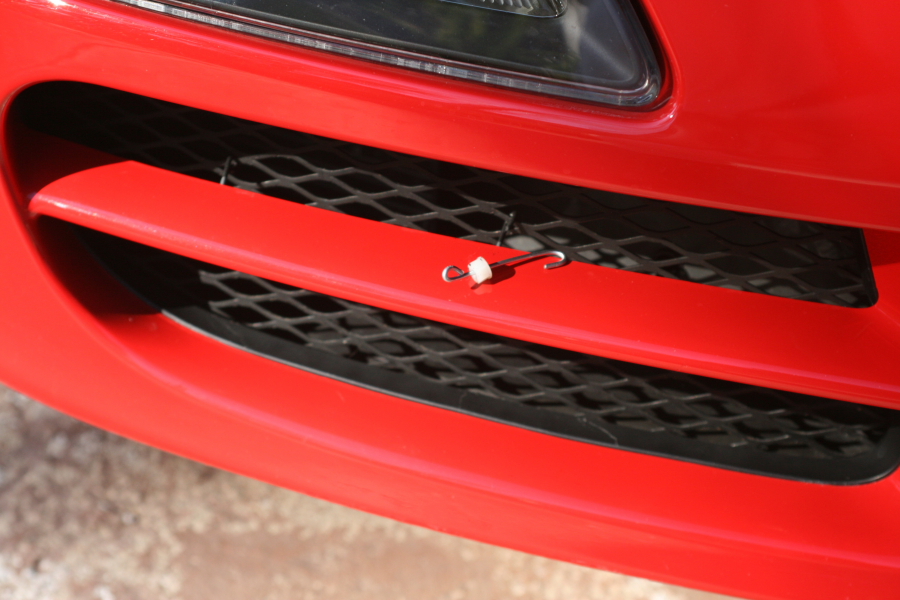

Hopefully pictures loaded up
If they did you can see a on the side grills two black metal rods that attaches to the front horizontal red body part. I made the rods using s/s and a nylon nut. The nut sits in a crevice/space that seperated between the red horizontal body part and the begining of the black air intake.

Okay I got it going....any questions?
If you look closely on the side grills there are two metal s/s rods that attach to the front horizontal red body part. There is a crevace/slit in that horizontal part between the begining of the air intake and the red body part. You can open it with your finger tips, slip the rod in, and the nylon nut sits in an open space inside that really takes alot of force to pull out. Between a snugg fit and that s/s rod, it stays in place. The middle grill is actually divided in two R and L for ease of installation (also couldn't find one long enough) and it sits in a natural groove.
Click on the image and it will magnify to a better resolution.

None...absolutely none. I think the trick is also to select the correct grill size..
Originally Posted by dndodd
Any change in the oil or water temps?
My grill is about 3/4" x 1/2 " openings. Also I don't track at 150mph in the desert. I think if you get very small holes you might interfere with airflow. NO BUMPER REMOVAL...its easy.
