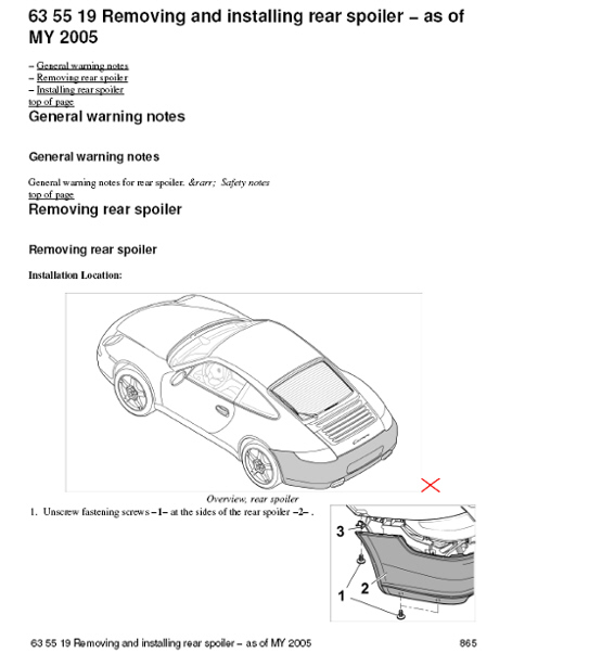

does anyone have instructions or pics on how to remove rear bumper? need to install muffler.

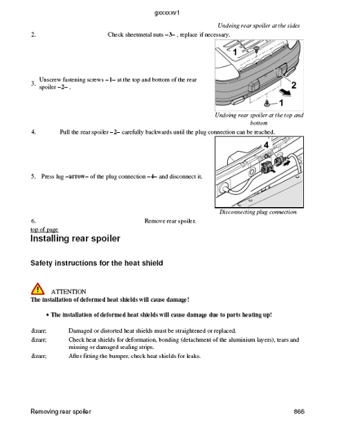

It's pretty easy ,just remove some Torx screws:

Where are these pages from? I would like to get that book.

On an aside, you don't need to remove the rear bumper to install a muffler. I removed and installed a muffler with jack stands.

Thanks for the info. Good to know I don't have to remove the rear bumper.
