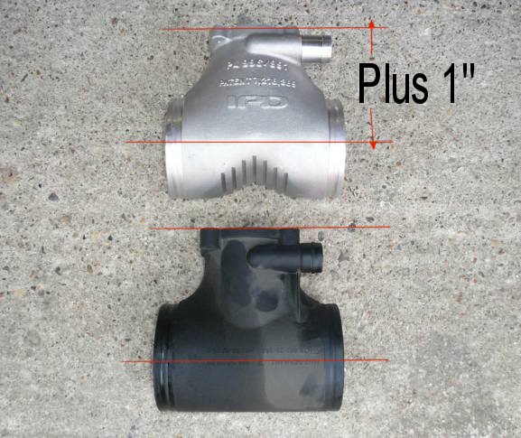

More and more curious! Two plenums on UK cars that don't fit properly, yet everyone else's does! If it's not the tee piece then maybe it's the inlet runners that are different? Certainly something's not the same. Anyone got any ideas?

Problem is it looks like you're absolutely right!!

Is it the correct IPD plenum?
Old Apr 16, 2008 | 10:41 AM
  #50
Ian_UK1's Avatar
Joined: Jan 2008
Posts: 407
From: UK
Rep Power: 42
Ian_UK1 is a splendid one to beholdIan_UK1 is a splendid one to beholdIan_UK1 is a splendid one to beholdIan_UK1 is a splendid one to beholdIan_UK1 is a splendid one to beholdIan_UK1 is a splendid one to beholdIan_UK1 is a splendid one to behold
I was hoping Greg at RSS could answer that one. It has 996/997 cast in the top. Wonder if there is a specific 997S (as distinct from 997/996) version that is shorter?

I measured mine they are the same.

Mine says 996/997 too.

I measured from the edge where the TB connects to the Plenum in the center to the center of the black connector. Aprox 2-1/4".

Originally Posted by Ian_UK1
Please see the attached image - the dimension I've shown is approx 1" longer in the plenum than it is in the stock tee on my car.
Edit: And the tee piece on my car looks nothing like the one in the pic. Totally different part.
Ian:
How did you even get it to fit with it being that much larger? Did you have to force it in? I would assume that the intake plumbing would have been difficult with the extension on the aftermarket plenum.
Also, that link I posted was from a London member. Not sure if it's London England though. His seems to fit fine, although it's a 996. It's my understanding that the 996,997, and 997S motors are essentially the same other than minor tweaks and in the case of the the "S", more displacement.

Anybody try measuring the overall picture? I did they are the same.
The distance between the red lines is different but the top picture bottom line is not centered across the center of the Tee.
IAN is this some kind of April Fools joke?

I think he is just trying to show where his IPD plenum is longer than the stock one. The pic posted is from another install.
