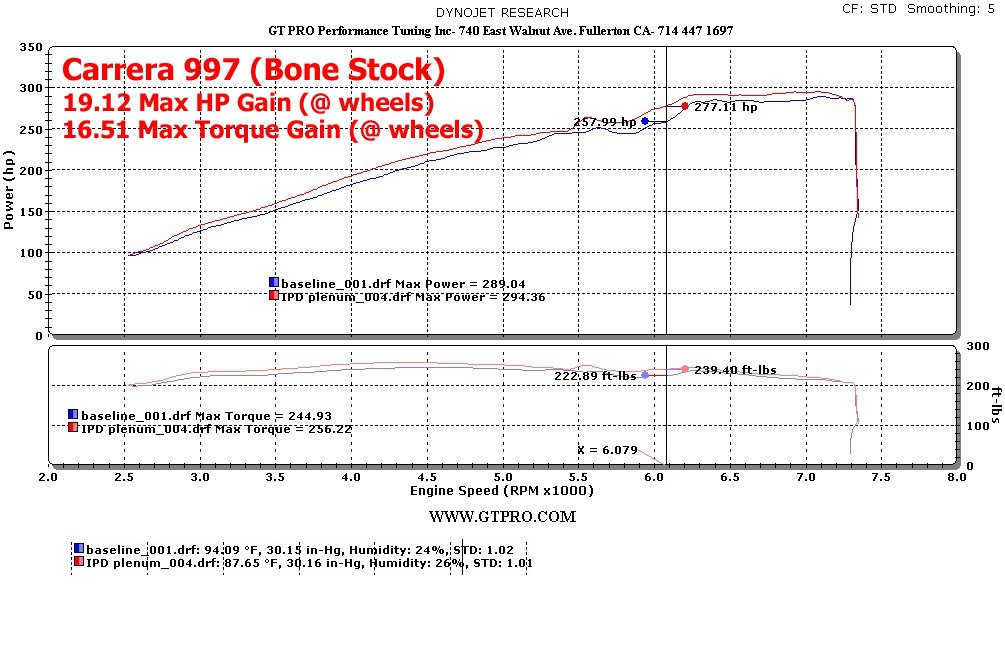

Here are the 997 dynos from the event
I don't know about you guys but here are a couple of damn good looking 997 dynos from the IPD Plenum Dyno Day. No dyno manipulations, No hype, No BS, just public dyno testing that proves the IPD plenum is the single best performance mod you can install on a late model Porsche. The gains are from beginning to end and the greatest gains are realized where is matters most, in the mid range. Enjoy!

There's no doubt in my mind the plenum makes real nice gains on the Turbo, I couldnt be happier w/ mine.
IMO it's most reliable, best bang for the buck, performance part you can buy.
