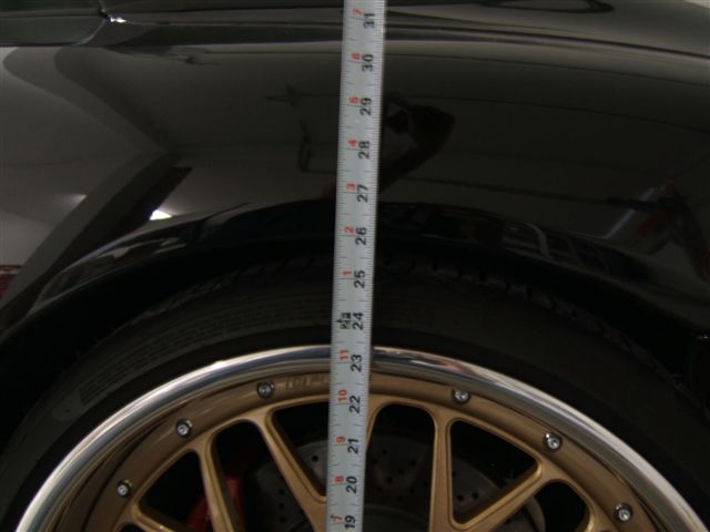

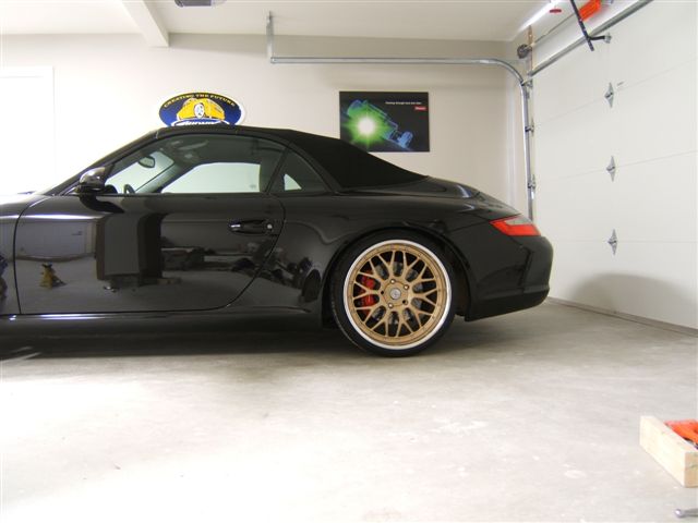

I am just installing coilovers right now and would love to see side pics of your cars as well as the wheel well arch measurements front and back please!
Might really be a useful thread down the road for people to refer to !
I am running a 305/25/20 Pirelli P-zero and I am at 26 1/8 inches in the rear.
Front not done yet.I will update later.
I am thinking that this rear height may be about 1/2 inch to low.I will wait to adjust until I hear from others !

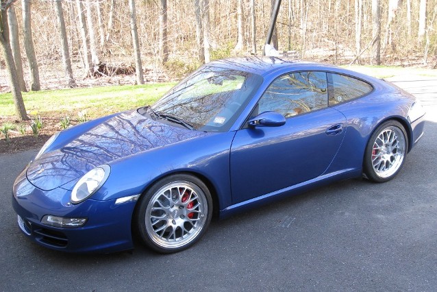

About 25.5" front, 26.5" rear the way you measured. Slope is 0.80 degrees back to front on alignment. Damptronics for PASM, GT3 Cup control arms, GT3 front sway with TRG drop links, H&R sway rear. Camber is -2.3 front, -1.9 rear. Razor sharp on the street, will report on the track after 4/24.
Photo as requested - 19" Fikse Profil 10s.
