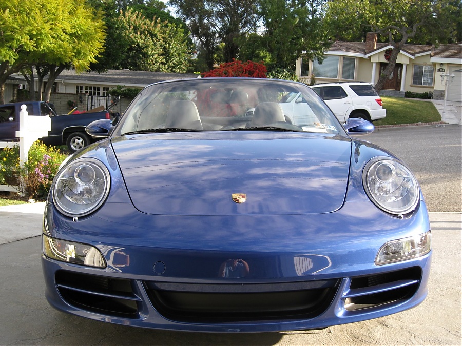

Here's an example picture post install to show you the results, if done right you can't tell. In this pic several areas were done, full hood, front bumper, headlight and leading half of the fender.
IMHO, I would leave the complicated bumper installs to the pros, you might spend a few hundred bucks on a kit but when you apply it and something goes wrong, you just wasted a good chunk of money that could've went to an installer. That said it sounds like some of the quotes you're getting are high, shop around and make sure to see examples of their work. Good luck!

This is done by premier, just same as Michael's saying.....customs the whole front and took the lights and other things out....
The perfect job that you can't tell.
