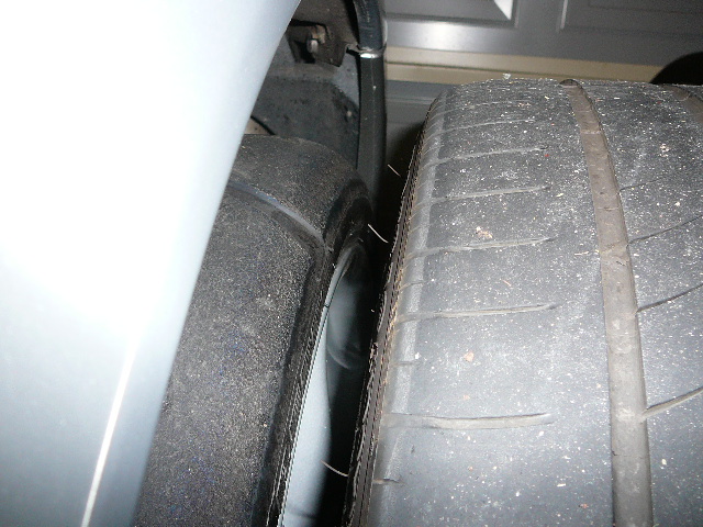

Spot on Mishref.
The comparison from 1010tires confirms exactly the issues I've experienced from having the wrong rolling diameter.
See attached picture...
To see the difference, the standard 295/30/19 on OEM 19" Lobsters is the tire on the right (PS2). The track tire 285/30/18 on an 18x10" wheel is on the left.
Clearly the OEM tire on the right is "taller" than that of the 285/30/18 or the right.
My OPC commented that C2's and especially C4's would have PSM/ABS issues if the front and rear rolling diameters dont match that of the OEM setups.
Also, since changing to 295/35/18's with larger sidewalls I find the rear tracks much better than before with a more progressive feel. Just MHO.
